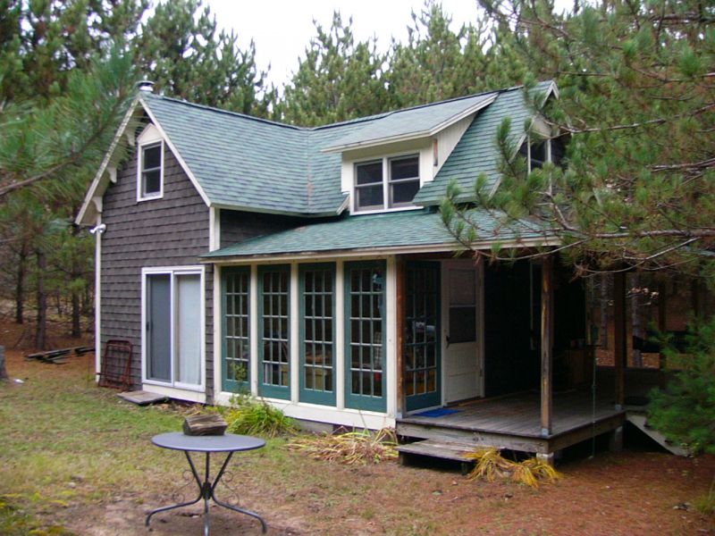

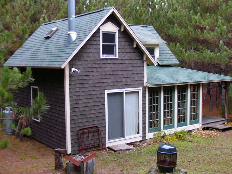

Hi there, I have already built the cabin and now I wish I would have dug a cellar underneath before hand! Any advice would be helpful...the cabin sits on a post foundation that is completly enclosed around the perimeter...do I cut a door in the floor inside the cabin and dig by hand? UGG! or dig from outside? anyone done this??? Thanks Dave

Here are a few pics..

No advice about the root cellar. Just wanted to say I love your cabin!

Hi Sustainusfarm. I really love your cabin! Would you be able to post more pictures of it? What are the rough dimensions?
