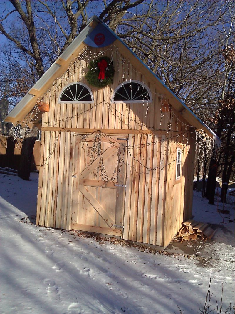

Before you stain or paint, I would use some borax and penetreat, this will minimize the bugs. Large overhangs keeps the water off.
Board and batten is great for green siding, you can cut it on the mill and nail it up the same day.
Board and Batten (Green)
