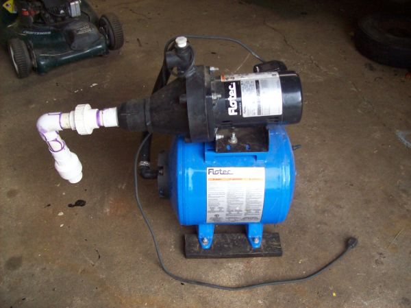

# Posted: 29 Apr 2012 05:42pm
I thought about your idea of the fire protection....I found a pump and pressure tank setup all contained on craigslist, its practically brand new....I will be getting bigger tanks and setting that up...I think I could just drain the tank down to half full and take the pump and pressure tank home with me?? Here is a pic of it....
