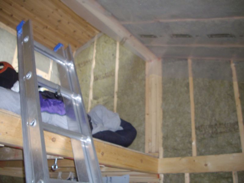

Yes you should definitely insulate. I've used roxul with a vapour barrier. It's not expensive and easy to do. Use Roxul if you can - less itchy than fibreglass. I have a direct vent propane heater. It's toasty inside at -10C. Oh - and the space is similar in size. 8' x 13'-6" with a loft bed.

It would be very drafty and use a lot of fuel, wether it be wood or propane.
