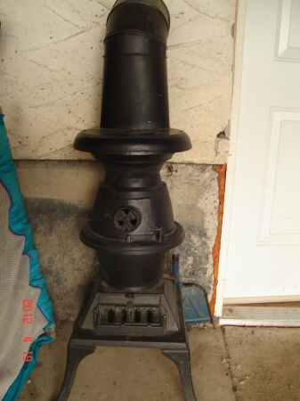

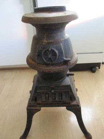

I've been looking for a small stove to heat my small cabin (100sq ft + loft).
I'm starting to lean toward an old, small potbelly stove. I've found two locally for good prices ($150 or $250). The main difference between the two is that for $250 I'd get the first few feet of stove pipe coming out of it along with the stove. The stove pipe has a 90 degree bend, but I will be going straight up through the ceiling, so it's not entirely useful. The main advantage I can see of getting the pipe with the stove is that it has the piece that connects to the stove. Is that bit of pipe tough to find and/or expensive?
ie., I'm comparing this stove for $150: http://images.craigslist.org/5I15H15M73Kf3F33Lec49b037379963b01f88.jpg
to this stove for $250: http://images.craigslist.org/5G35Jd5M33Ka3J23Nec4j1f332715717b1764.jpg
Thoughts?
Thanks!

I think the stoves in the Craigslist ads you linked to are "coal stoves". I like their classical looks, but they don't burn logs well because the wood will be "vertical", it burns too hot and too fast. You might have to cut your firewood into short "chunks" (like a pile of briquettes), as opposed to "logs".
Here's a pic of one of those little stoves that I tried in my cabin. I paid $500 for mine. It was made in 1944, and was brand new condition, virtually unused. It didn't work for me but the C/L competition was fierce, so maybe I can sell it for $500.
See a similar thread called "Heating a small 10x10 cabin?"
It took 2 full days to get my 180 SQ Ft cabin warm, and that's babysitting it, loading it full which was about 2 hours burn. It took a LOT of effort to try to heat a Log cabin (so much thermal mass). If I came back to the cbin in 2 1/2 hours the fire was OUT. I removed it and installed a conventional stove (Vermont Castings "Intrepid" from 1982 ) where the firewood lays horizontal. Now it takes "less than 2 days" to get the logs warm. I re-posted your craigslist pics (below) because in 7 days the Craigslist Ads you linked to will be expired then nobody can see the stoves being discussed. $125 craigslist stove
|  $250 craigslist stove

Never thought of the coal stove angle. If they are there should be a grate in the bottom. At least any coal burners I've seen had grates with an ash pit below.
TomChum
# Posted: 27 Apr 2012 10:52am - Edited by: TomChum
Yes there is a little grate that the coal sits on. The air control below is in a door which opens to clean the ash pit below.
I suspect it was about 1/2 size for my cabin, thus it might be fine in a 100 Sq Ft, modern well-insulated cabin that's NOT logs. If you want your cabin to warm quickly, insulate well and don't put heavy stuff on the walls (sheetrock) use something lightweight (wood).
One of these may be the right stove for your 100 Sq FT cabin! They look cool, don't take much floor space and the price is right. And I suppose you can sell it if it doesn't work.
Don't worry about the oval stovepipe, it's just a normal 6" pipe that you ovalize by hand and slip it over the joint.

The two stoves shown are small laundry stoves. They are coal stoves, which is one reasons why they are so small. They would not work too well for wood. You woulld have to cut small chunks of wood to burn in the fire box, and you couldn't put too many in ata time. More work for less heat, that is unless you had a coal supply close by. I do like the looks of them though, meaning the are visually pleasing, but not vary practical.
