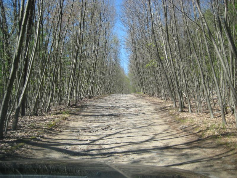

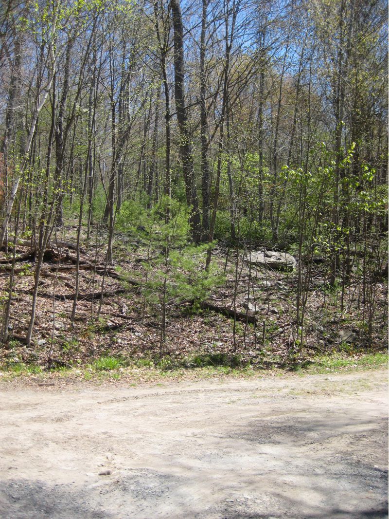

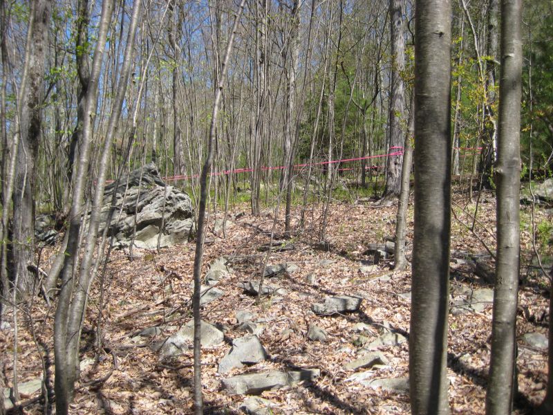

I just came back from the land. I will go ahead and buy it.
An excavator that I called came there to talk with us about a driveway. It so so essential for him to show up because before he arrived my wife and I were looking around and thinking that the lot, near the road, is too steep and rocky... I already started thinking that this will never be possible. But the guy said that this is actually not as bad as I think. He said this: He will make a 450-500ft deep road. He will go from the side to avoid going up where it is steep - which will make our climb a lot simpler. It will take him 4 days. He will install a 15" pipe somewhere in the bottom. The 'item' (the material he will use as gravel or something) will be from a local quarry which has a very inexpensive stone (according to him) - they charge $300 per load and he said that it has between 12-15 yards in it. This will give 4" for the road.
He quoted 6000$ including everything.
Questions: He said that the biggest cost will be the gravel thing. What will happen if I won't put it down? I know that you SHOULD put it down but it will cost me half not to.
What I am contemplating is that if he doesn't put it down, and soon after he makes the road, I bring a HD truck there with the majority of the materials I need for the construction then afterwards - I do not really need a very good road for the cabin. I will bring very minimal items or materials for the construction which shouldn't be tricky to bring up.

First of all nice looking piece of property. As far as the driveway goes are you going to be doing the cutting and clearing the driveway yourself. Do you have a 4wd vehicle to get in. It looks high and dry so mud really souldn't be a problem. If you are cutting it yourself maybe see what its like driving up to the cabin spot without any road work you may be surprised. What are the pink lines in one of the pics? Almost looks like the big tree is a sugar maple, maybe sap lines? Looks like a perfect piece of property, congrats! Brian
VTweekender
# Posted: 29 Apr 2012 08:01pm
opti, thats a reasonable estimate......if he said the 15" culvert is needed then it most likely is needed..he is thinking down the road for you so there are no problems at that area..must be runoff there when it rains...the gravel will solidify the base of your road..without gravel most likely will have a mudbog of a road...especially in the spring with snow melt and when it rains..
optimistic
# Posted: 29 Apr 2012 09:10pm
Thanks BRL. The lines are actually where we marked the closer cabin location but we will go much further in. I do not need to do any clearing really. The excavator will push everything away. He says that he will just knock the trees down and that will be it. I will need to clear a few small trees where the cabin will rest but because I will install Techno metal posts - I do not need to completely flat it as the guy will be installing them 12" above ground. There is no way I can get my 4wd up there right now. zero chance.
weekender - I agree on the culvert. You said that the road will become a mudbog but is that in terms of - mud so you get stuck or can slip and crash with the car or mud so you are battling to get up there and then you have to be covered with mud? necessity vs. convenience?
I am trying to really understand what will happen if I will skip the gravel. If it will make my life a bit harder or impossible/dangerous?
