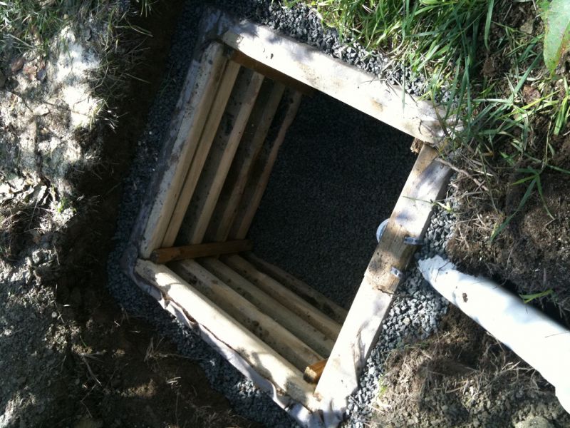

 If you are dealing with a building inspector that is discussing compost toilets and privy's, he should also be able to provide details on a leaching pit (and the requirements needed).  A privy is not designed to get rid of greywater.  I cannot say exactly what is needed in your area but at my property it was easy to build - about a 4x4 ft hole, gravel on bottom, lined with some material that allows flow through on the bottom half and solid on top half.  It also needs to be airtight at the top.  You will have other rules that need to be followed.  In addition, in our area you cannot use a pressured water system (include gravity).  In other words, it is designed for small amounts of grey water.  Here is a picture of mine before I put the top on it and covered it back up with soil.
