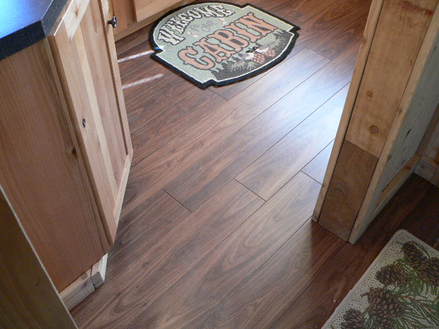

I just installed engineered stuff, no glue, no nails, floats on a foam pad.
flooring
flooring
