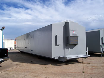

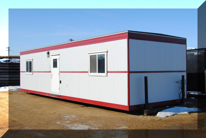

VT thanks for the advice on going 16" centers, will do that. Here are a couple of pics to show the type of skid I am building to build the cabin on top of. The frame I have is tall enough for the bottom of the cabin to clear/go over the trailer fenders when pulled up with a winch. With the skid like this, will the overhang of the joists need more support. The older skid mounted bunk houses were wood framed much like a trailer house/mobil home is now, but I never really paid attention to how they supported the overhang past the skid. All I see now are all metal buck houses.

I would imagine that the overhangs are supported after it reaches destination with blocks or more skids set under....either if the bunk stays on the trailer or it is unloaded...I think it would be fine if just transporting it.....snow load or something heavy set near the outside walls would be the concern after set in place.
