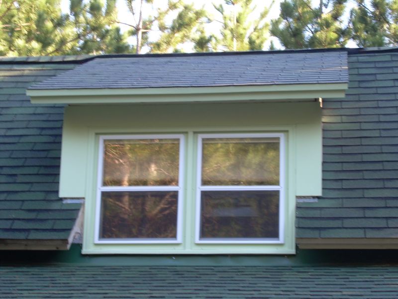

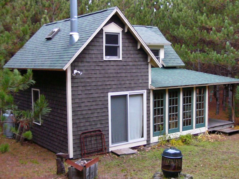

Do you all think this is a project for the DIY person? I did build the entire cabin... I think I need to research what tools I will need ( cant imagine I dont have them already)! I know how to flash regular shingles but metal roof ???
One other question...as you see in the pics I have a 12/12 pitch that falls onto a 4/12 pitch on the porches....what about snow load from all the snow coming off the 12/12 roof and piling up on the 4/12??? As it is I have 3-5' of snow pile up on the roof and sit all winter like that...no issues in 15 yrs....

Thank You Malamute!! That was alot of great info! I really appreciate it! I can now make a plan t otackle this project. ErinsMom, I am working on it...since I started building in 1996 alot of the early oics are "real pictures" in an album! I am working te get the digital so I can post a timeline here.
The windows are pine french doors that I take out for the summer and replace with screen doors. I got for $40.00 ea long ago when I was storing materials for the cabin before I built.
