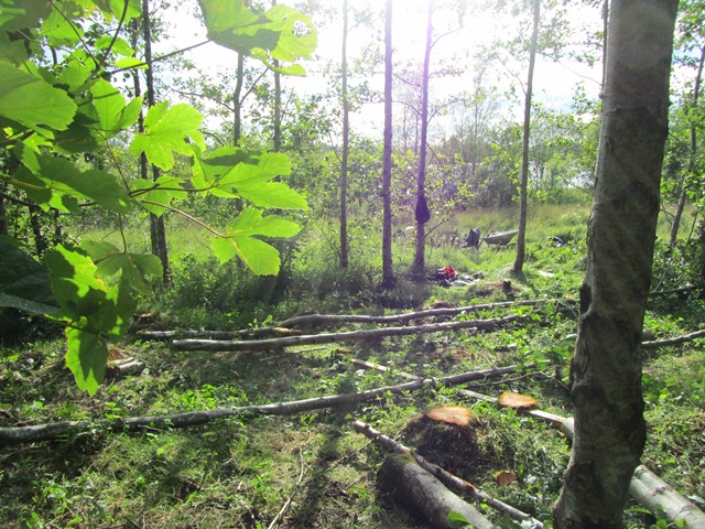

I live in damp wet Ireland. I want to build a low budget cabin in a woodland, big enough for me to hideaway, have a little stove to heat/cook on, table, chair, bed. I'm thinking roughly 5m x 4m (16ft x 13ft) or whatever fits easily with standard sizes of materials. Its also an exercise for me to learn how to build and for my children to witness this so they know its possible in the future when the time comes for them to do so and avoid a mortgage etc.
The soil is clay. Winter temps at worst are generally -5c (23F) for short periods of a few days, although we had a freak winter 2 years ago which went down to for a couple of days (1.4F). The site is on a slight slope. I'd say a drop of 1ft from back to front wall.
I'd love to hear views on foundation options.
So far I've cleared a patch (willing friend good with a chainsaw), that was last summer. I just purchased a drill. I'm good to go.
