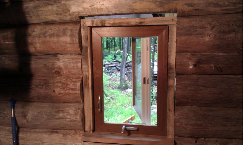

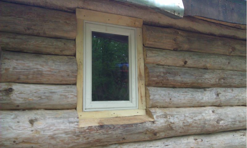

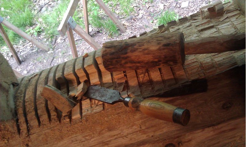

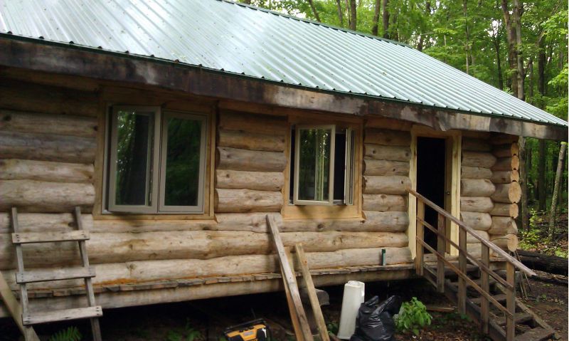

This weekend, I finally got around to putting in the kitchen window at the Stump Ranch.
The header was cut before the log went on the wall. I cut the opening with a chainsaw, flattened and sloped the sill with chainsaw, axe and chisel. Cut the slots for the 2" x 4" keyways and then framed up the window. Cutting the window sill
|  Window in the rough opening
|  Window Trimmed on the outside
|  Front of the Stump Ranch

Chisel work was quick, 2 minutes with a chainsaw to make the cuts, knock off the waste wood... another 5 minutes, and then 2 more minutes to brush the sill clean with the chainsaw (however, if this is the first time you brush something smooth with a chainsaw, well, it will take an hour and it will not be smooth).
Everything checks...no problem. Checking will occur at the cut or feature (i.e. mortise that is nearest the heart). Checking is no problem for strength. My logs generally check on the bottom as there is a lateral groove that runs the length of the log. The check will run to the heart and stop.

It works well to knock the chips out with a hammer also. I just whack them sideways and they blast out very fast. A chisel can clean up the few remaining knobs, or the chainsaw. Using the saw at an angle to clean up the kerfs helps(I do both 45 deg directions to get them evened up.), until the high spots are all even, then you can go at a 90 degree angle to the log again. I call my saw my chain plane when doing that, and evening up flats for roofs. I've gone to an electric hand planer for the flats for the roof though.
