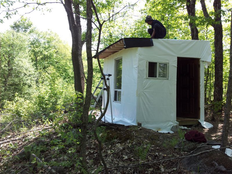

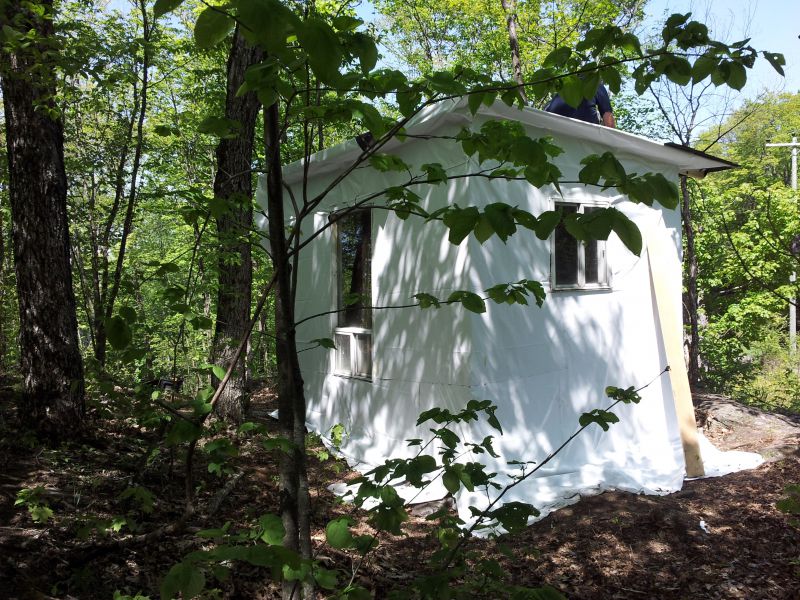

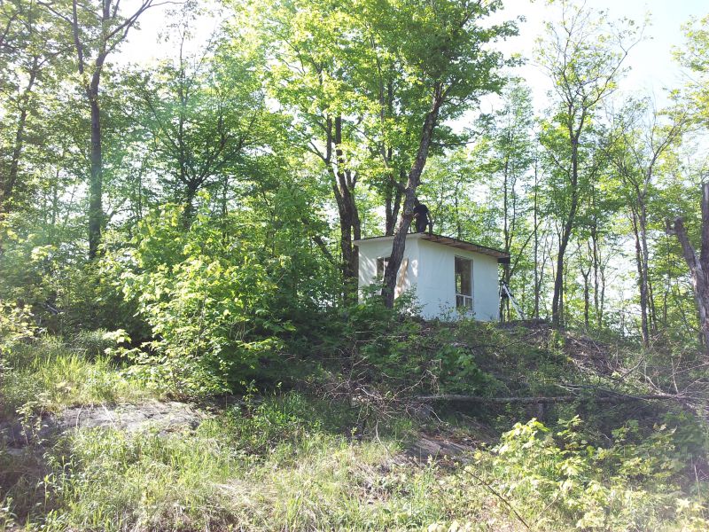

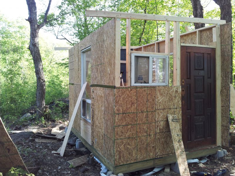

  Hi all,
  Ive been gathering materials over the past while and have made the move to start the build!
  couple weekends ago build the base, this past weekend we built the frame and the roof. Got alot done! Used Plywood all around and used heavy duty tarp for the exterior vapor barrier.
  What are you thoughts on finishing the exterior? Shingles? Smart panels?Wood? other? Doesnt have to be pretty just durable.
  for the slanted flat roof, i have to cover / wiremesh/screen all the areas where the roof joists meet the walls. Do you think 2 stud spaces per wall will suffice?
  Any other recommednations and comments are appreciatted!!

  You must use blocking in between roof rafters. This would be where you bird blocks would go. The blocking keeps the rafters from trying to flip on their sides. Its eaiser to install them before roof sheating, but ding it adfterwards isnt to tough, especially if you have an air powered framing nailer.
