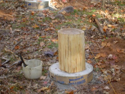

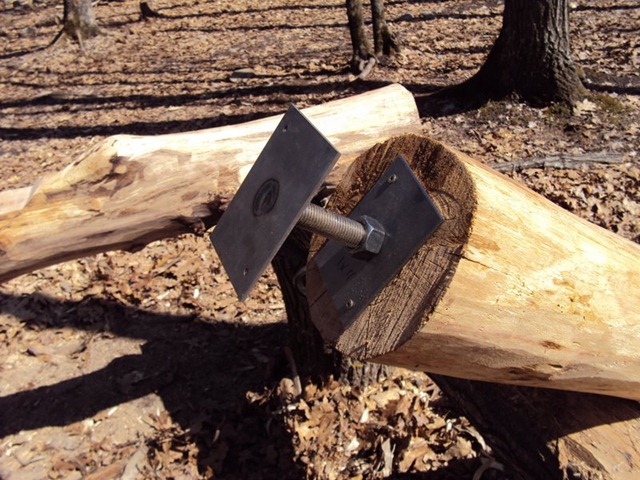

Anchor some screwjacks to to the stones. You can drill a hole in skids, beams, or posts to account for the Jack. This will give you a foot or so of adjustment to account for frost heave.
You could also dig some holes and fill them with sack-crete. However, I too, have to get to my cabin via ATV, so that changes things a great deal. Instead of a hole below the frost line, you could with 12" x 12" x 12" hole filled with rock and concrete with screw jack for adjustment.
Here is a source for screw jacks:
http://www.loghelp.com/c-40-log-home-screw-jacks.aspx
Or, if you have a welder, you can make some up.

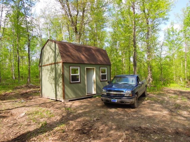

I'd say go for skids. This is a 10x8 shed we have that's on two 4x6 skids. I don't think it's going anywhere. Each skid is supported on the two ends by cinder blocks the land's previous owner was kind enough to leave behind. In your case, maybe use three 6x6 skids, each supported in three or four spots? I think it'd be good.
The Low shack by bobbotron1, on Flickr

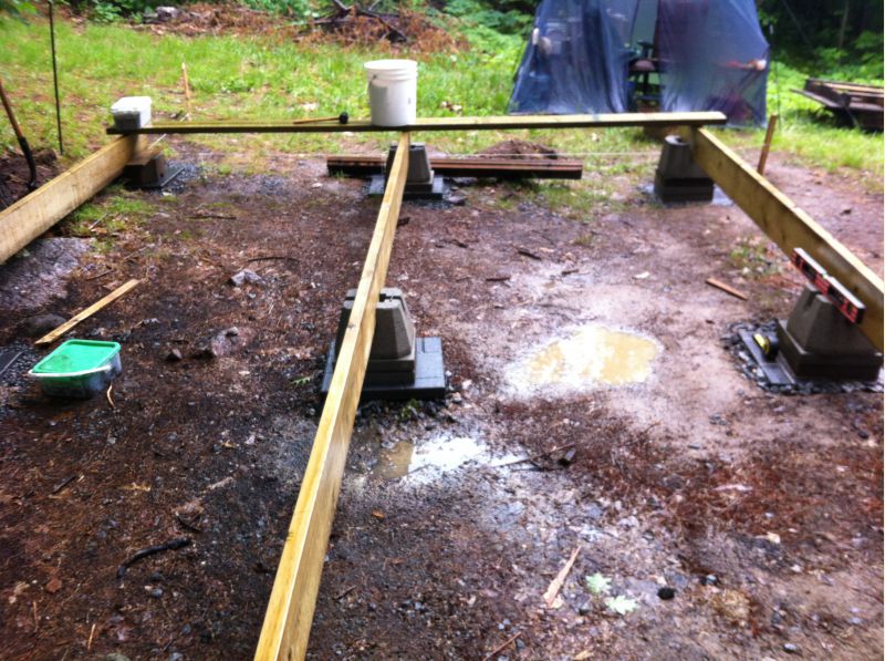

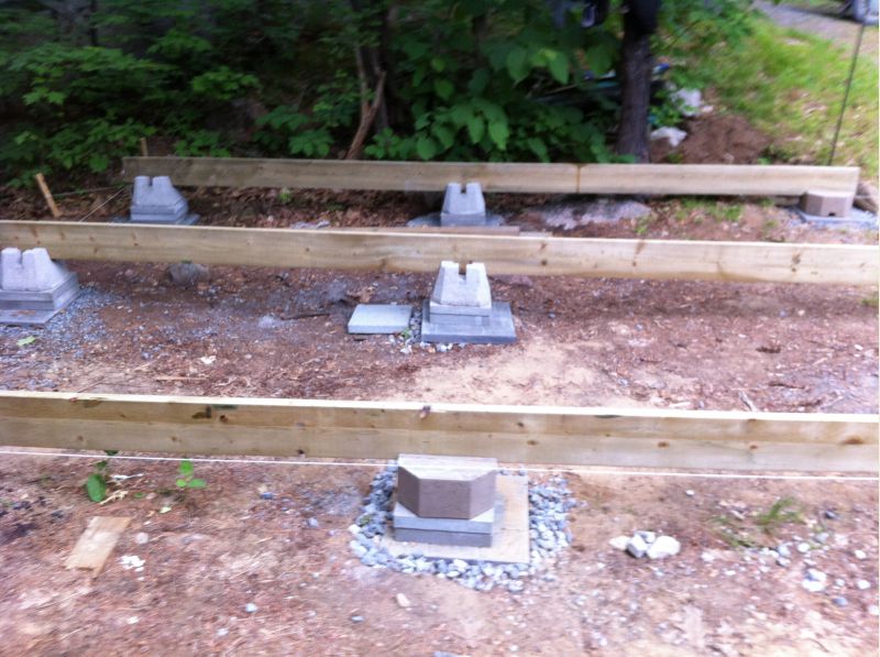

# Posted: 31 May 2012 09:56am
Quick question on foundation design for a 12' x 16' one level, slopped roof, basic cabin/shed.
We have started the foundation.
See pictures. Below....
We decided to not to drill/sono/rebar footings.
We instead dug 20" x 20" x 4'-10" deep holes, filled and pounded gravel in, levellled and added 18" x 18" patio stone for level footings.
Then stack (level) 2 x 12" x12" flat pavers, and added the concrete deck block on top, will mortar and adhesive them together, and concrete over gravel footing.
We have 9 (nine) footings.
We are planning (3) - 2"x 8" x 16' support beams, and using 3" x 5" fir cross supports to tie the floor supports together, cover with ply.
We will also brace some corners with 45 degree angle 2" x 8", and add corner metal brackets.
Questions:
Do you think this is a decent enough foundation, and support beams for this size of cabin?
Do youthink we need 2" x10" beams?
Foundation columns? Do you think this will both support and not be to affected by frost, heeving etc.
There will be 3-4 windows, and door.
The ground is rock with sandy soil. The cabin will be sheltered, and will have a small deck (eventually) attached out front. Cabin looks north west.
Let us know asap, we continue this weekend...

# Posted: 31 May 2012 10:42am
See foundation pictures, 12 ' x 16' cabin, one storey, sloped roof, small wood stove - supported under floor.
foundation - cabin
foundation - cabin
tex
# Posted: 31 May 2012 10:50am
See foundation con't:
Note: 3" x 5" Fir cross beams, (we have 16 pieces), on 24" centres...
(yes - these are large recycled beams...)
cross beams - for foundation

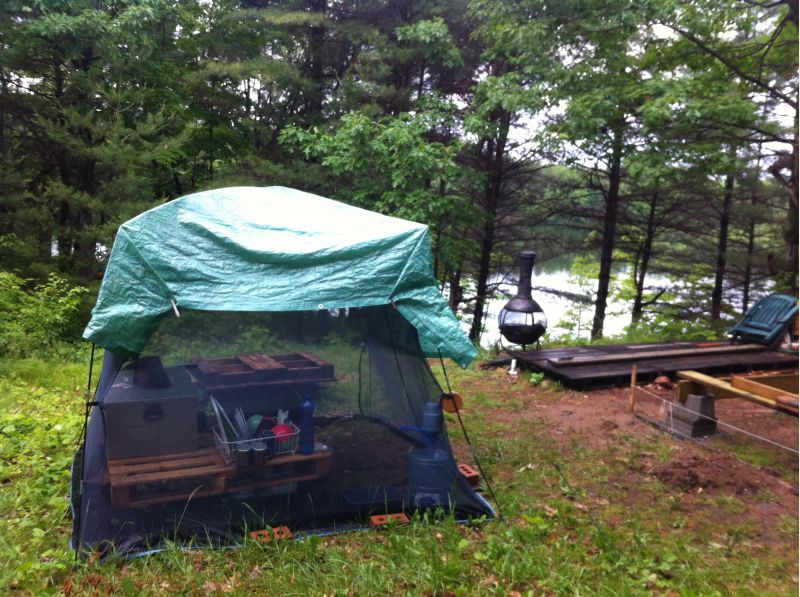

# Posted: 3 Jun 2012 06:46pm - Edited by: tex
Here are some washed out weekend snaps for your comments.
"Blanche", the wife.. set up a kitchen and cover for today and project.
Well used today!
Called German...father in law for mortar tips, need to mortar and parge the supports to level this week.
Next to square and add 2"x 8" cross members and include 45 degree braces on four outside corners.
Next weekend to insulation of floor, 2" will due, add tar paper cover then T & G ply. 3/4" ? Hmmmmmmm?
Looked at the rain today, (lots) it seems we have sandy soil, very important to know now were water goes and what drainage will be needed. Especially with "floating" supports".
Buying (used) windows from local recycle yard next weekend and get T & G ply misc.
Will stay over and "Blanche" and I will try to finish up the platform, store and think about wndow design locations for light and views. We have a window we took out of our home kitchen, that has a built in retractable cover, European homes have these to keep out, in, heat. That one will go on the south side! Gives security and good protection from storms too.
Need to consider wood stove location for both floor support and safety.
Considering front left location for prevailing north winter winds. And tree forest hazards.
Roof will be 8' height sloping to 7' to back of cabin. This is not a house a basic cabin and porch. We do not want or need a large empty space.
See snaps of washout weekend!
Please comment.......

# Posted: 4 Jun 2012 10:26pm
if the water is flowing under your cabin, then I'd dig a few swells to redirect the water to flow elsewhere. Now would be the time to do it too.
