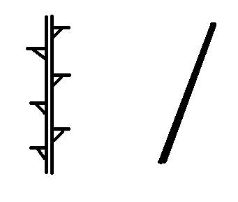

I have an idea for stairs.. I haven't seen it anywhere and I haven't built mine yet so I cant say if it works. I will try and attach my wondeful drawing
The benefit of this design is that you can put it almost verticle and it should in theory be easier to climb then a ladder that is at the same angle. Might have to play around a bit with it. Just a suggestion.
The drawing on the left is if you were looking at it to climb up the stairs and the one on the right is just to give an idea of the angle.

looks like a version of a jefferson stair or alternate tread design. i really like the concept of that design but my buddies arent thrilled with it and i wonder if my 68 year old dad and father-in-law(along with my ability in years to come) would be easy enough to traverse.
