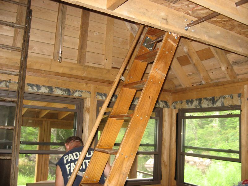

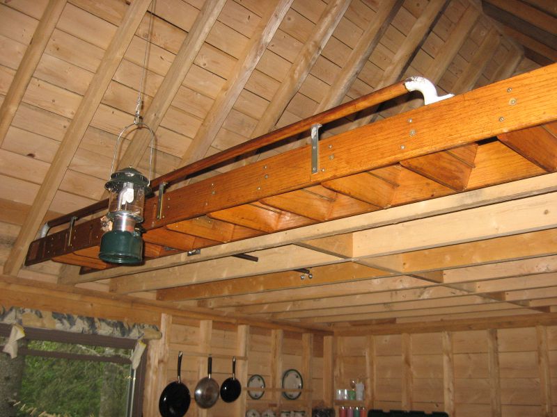

This is how I saved space with my ladder. A 1" pipe used as a pivot. Works real good. Up during the day for the most part then down at night or when we want to be up there. July_20_012.jpg
tbjohn
# Posted: 5 Jun 2012 06:45pm
Oh ya, I have pulleys and just a carribina on the bottm end that I snap on and put the ladder up. Then hook the loop (handle) on a holder.
