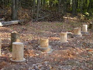

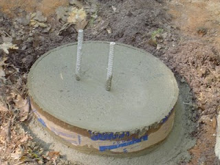

# Posted: 16 Jun 2012 10:48am - Edited by: fpw
I like concrete. My cabin will be standing long after I am gone. However, it was great deal of work. In particular because I had to dig down below the frost-line by hand and mix the sac-crete in a wheel barrow. With a bobcat and auger and a cement truck it would be quick work.
We are working on a timber frame cabin from my brother in the same location. For this we decided to use wood post piers. We will obtain either railroad ties or phone poles to set in the ground. This will save us a great deal of time.
And, if one of the stumps does rot. A little jack, a chainsaw, and a couple of hours, you can have it replaced. If the wood posts rot off (at ground level) replacement is more difficult.
Either way, make sure your design and grading keeps the water away from the posts.
