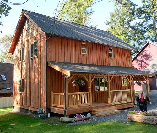

We are wanting to build a 20 x 24 "cabin" that we will make our permanent residence. I am sure others on this site have done this so i am looking for some words of wisdom from those who have succeeded in making their cabin their home. I would appreciate all thoughts and advice on all aspects from construction to things like power, heat etc...
Our plans so far are to build a basic 20 x 24 cabin 2 story cabin, similar in style to the attached photo but smaller. The main floor will have a mudroom (with 3 kids and 2 dogs that is a must ), kitchen/living room area, a half bath and a pantry/storage area. Upstairs will be three small bedrooms and full bathroom.
