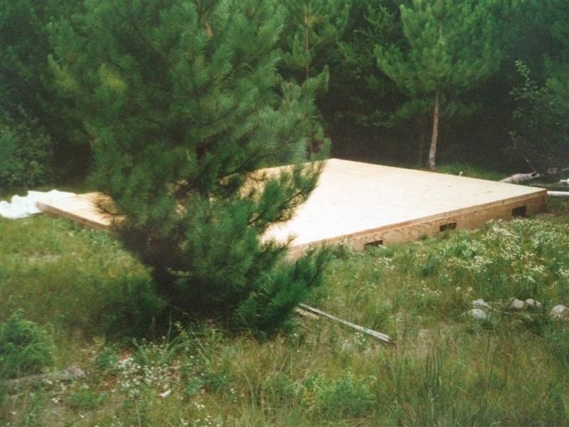

Sustainusfarm
# Posted: 21 Jun 2012 11:23am
I just skirted mine with pressure treated plywood and sunk it 2 ft into the ground, attached the foam to that and backfilled with the sandy soil I had dug out in the first place.
Not sure if you can see the skirting..it is 1 ft high on one side and 3ft on the other
