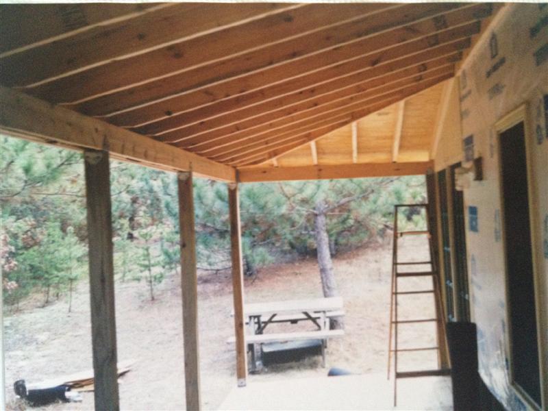

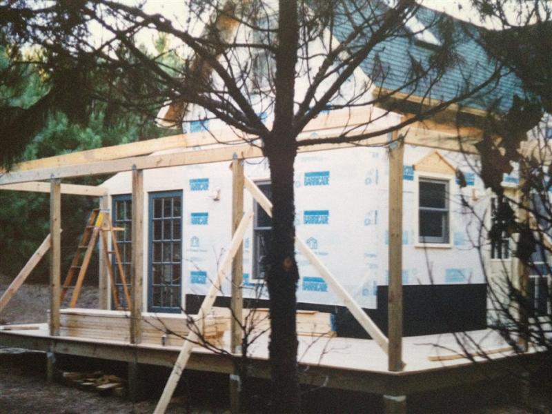

I have a porch roof and I will be finally enclosing the underside of it with T-111 beadboard....question is: How do I ventilate it once it is closed in? Do I need to ventilate it to extend the life of the roof shingles? I understand I can put a continous vent along the soffit edge fo the roof, but what about the ridge area where it butts against the cabin wall? What is the best way to do this?

You want inlet vents at the lower end, and outlet vents above. Can you install round holes with screens at the top between the rafters, (like bird blocking vents) I assume this goes into an attic??? Then the strip vent below like you mentioned.

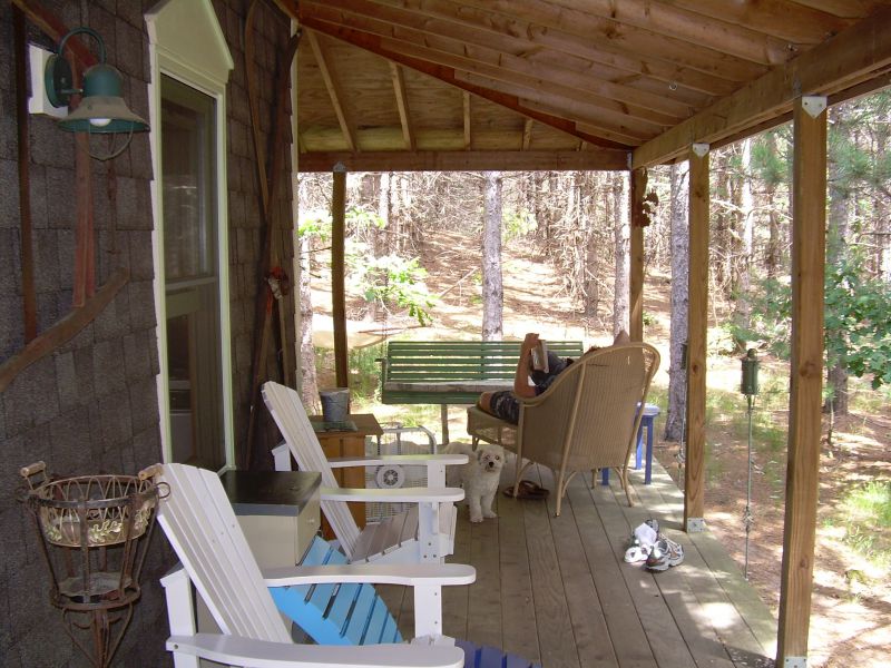

It does not go into an attic...porch roof is attached to the sidewalls of the cabin...does this pic show it better??
# Posted: 20 Jun 2012 10:22am
I doubt it will ever be a problem, but if you want you could put a vent in the shingles near the cabin. Porch roofs don't get quite as hot. It looked to me that you had a hip roof end to the porch roof, so I quess a gable roof vent is out.

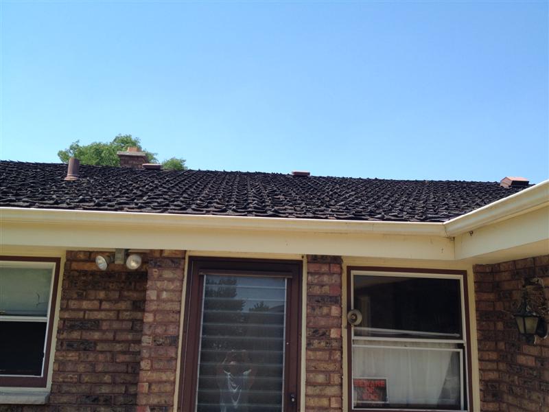

I am enclosing the underside though...I was worried about heat build up and premature shingle failure?? I have seen unvented roofs here and shingles that have just curled right up...heres a pic...
asphalt shingles with edges curled up 2-3" on the corners
Anonymous
# Posted: 20 Jun 2012 07:30pm
That can possibly be caused by an extremely overheated attic space in combination with moisture issues, but you only have a small gap between the porch ceiling and the roof deck. Not much air to heat up (and no moisture source).
Shingles that curled are likely really old, improperly installed, or defective (or all three!).
