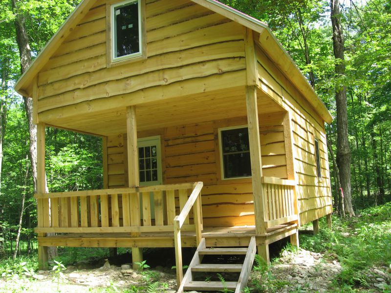

All of it, At least if that's not whole log construction and your doing it all yourself, and you don't waste wood.
This 12 x 24 cost about $5,000 in materials.
Owen

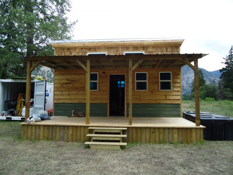

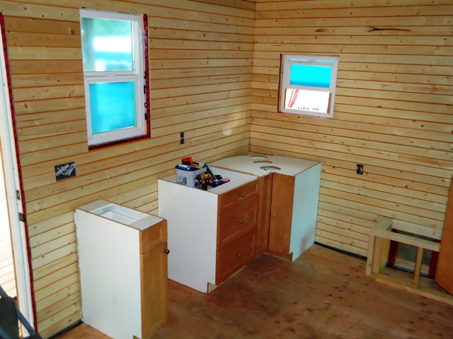

HopefulHomemaker
Yes it can be done I live in BC Canada were prices are not cheep and I am close to finishing my 16'x20' cabin and I have done all the work myself and My cost to date is about $4000.00 and that is with T&G pine interior, cabinets, counters, fixtures, flooring and fire place and the extiror finished with ceadar siding, shakes, meatal roofing, vinal windows, steal door and the deck. All matirials were new (purchased second hand make craigs list and your local used building stores your friend...)
Good luck you can do it...
