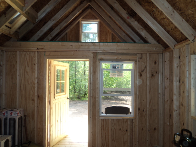

I'd use treated skids. Two set in a foot or so from sides. Make them from three layers for laminated 2x8's so they won't warp as much as soid 5x6's. Block them level with 4'' cement block or bigger. Yes, air space is your friend as far as wood rot, but in northern climates , it's nice if a foot of snow will block drafts. A 12x 16 does make more sense. I'm not loving lofts. They get too hot to sleep in, ok for storage though. Here's a 12' x 18' with 6' porch and two lofts.
