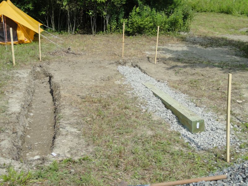

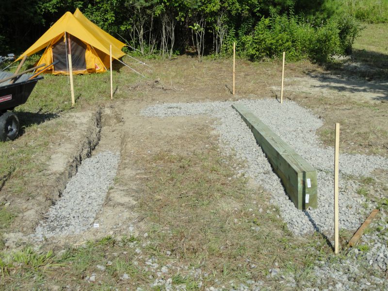

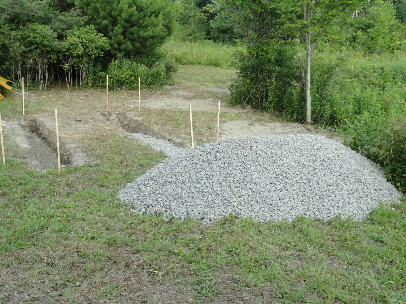

# Posted: 28 Jun 2012 12:26pm - Edited by: adakseabee

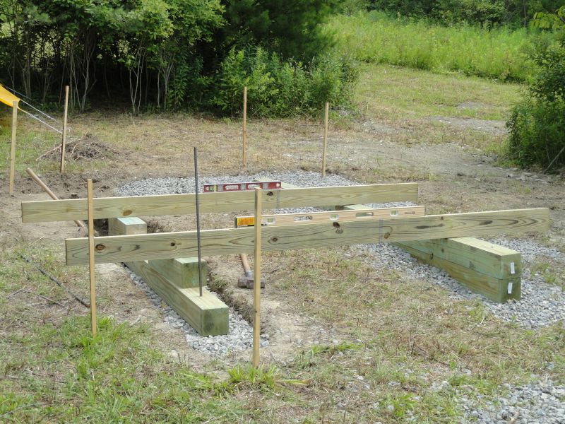

flyrdr, last summer I built a 10'x14' shed/cabin on 6"x6" PT skids, doubled vertically, that are rated for ground contact. I excavated two trenches about 16 inches wide, each 15 feet long. The ground slopes 11 inches over the 14 foot distance. Into the trenches I added crushed stone, at least one foot in depth below the 6"x6". On the downhill side the lower 6x6 skids are 8 feet long over which I placed 6x6 skids that are 14 feet long. Through the doubled skids I drilled 1/2 inch diameter holes (4 holes for each set of skids) through which I drove 1/2" rebar using a sledge hammer through the skids into the ground below. I also removed about 6 inches of soil from the uphill side of the site and replaced it with crushed stone in order to increase the distance between the soil and the bottom of the floor joists. In retrospect, if I had to do it all over again, I would have added another 6x6 on top. This summer I hope to complete a trench around the entire cabin and install drainage pipe to capture any water flowing downhill and off the roof. This cabin is in upstate NY and the subsoil is clay so I have a real concern about water in the soil under the skids freezing and lifting the building out of level.
The photos should help to visually explain what I am trying to explain verbally. There are 5 photos total, three attached to this message. - Adakseabee
Trenches and stone
Trenches and stone
6"x6"x8' and stone in one trench
6"x6"x8' and 6"x6"x14' and stone in one trench

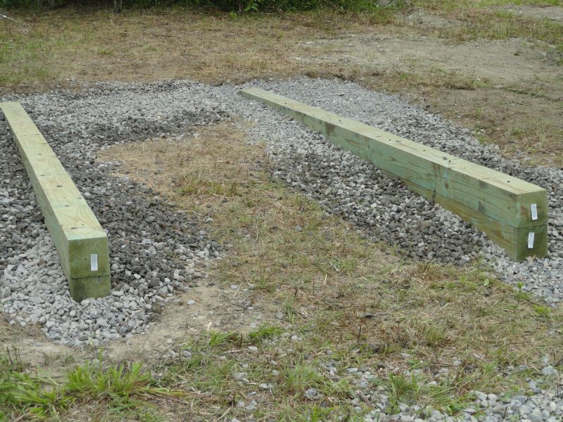

Here are the remaining 2 photos. In the first of these two photos, note the rebar in the 6x6x8 skid to the left that will be driven through both the upper 6x6, through the lower 6x6 and into the ground below.
Checking level from one side to the other.
Ready for the floor joists

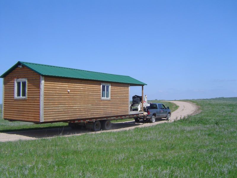

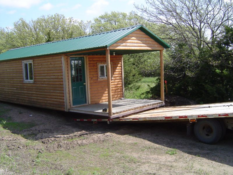

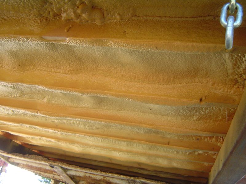

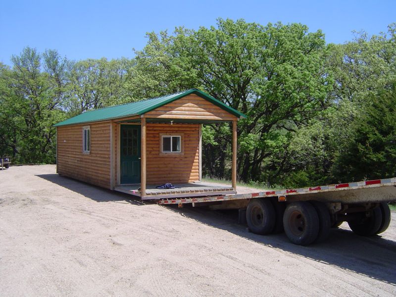

Our Cabin is build on steel skids and dropped and a bed of gravel. It's been in place for almost 15 years with no real issues. Picture 01 is the loading when we bought it. 03 is the underside which is sprayed with some kind of foam mice don't like. Never had issues yet with mice. They nest under cabin but don't chew anything. 04 is the cabin being moved.

NBNK
# Posted: 17 Mar 2021 03:13pm - Edited by: NBNK

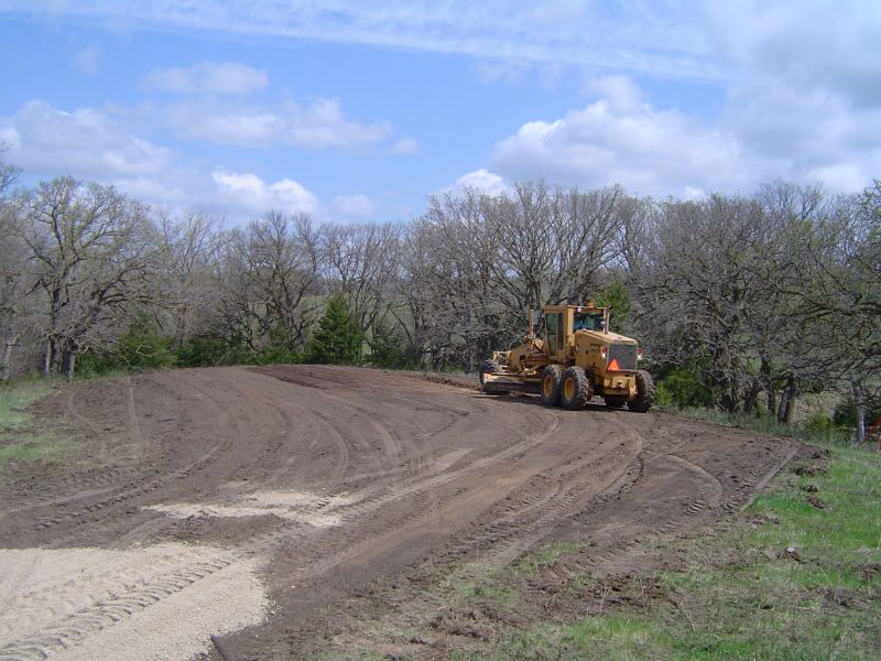

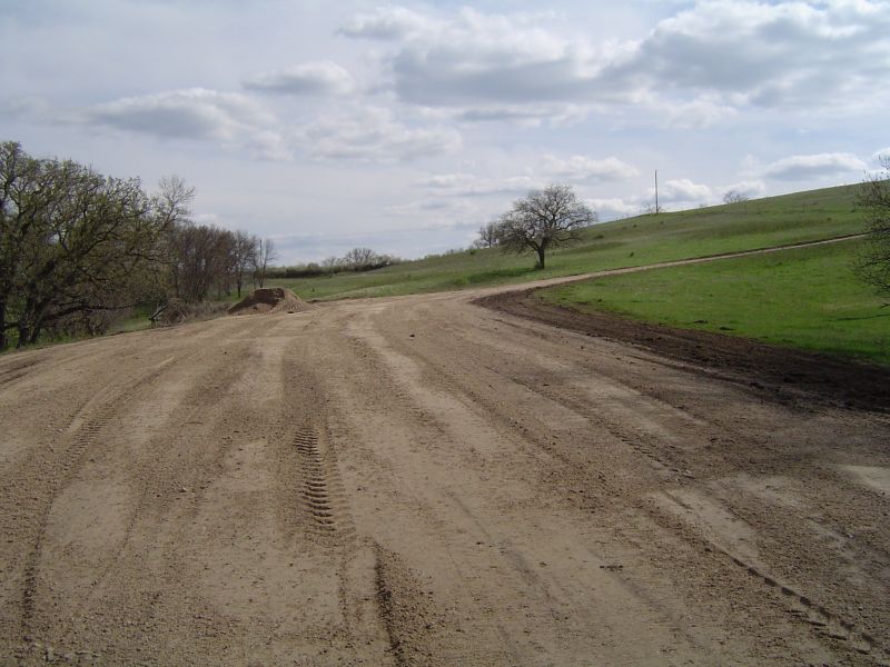

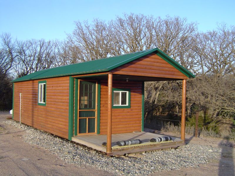

Moving cabin on steel skids. Level ground, pad of gravel. Drop in place. End of move. Almost 15 years in place.
Grading pad
Grading pad
Gravel base
