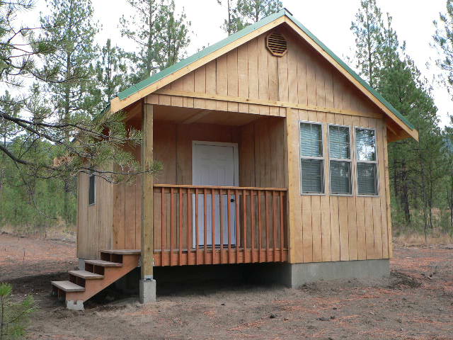

  Ok, I have a cabin I just built last summer and wnet the complete footing/stemwall. I asked lots of other locals who built and they used post and pier. They all regretted it, saying it wa simpossible to keep varmints out (mice) and the work was more than the footing/stemwall. Concrete use was close to the same too. I built mine with no outside crawlspace, but a trap door on the floor inside the unit.

  Another drawback that occurred to me last summer during the fire season on a post system in addition to varmints getting into the insulation easily is fire, sparks blowing under it. The full footer if you can get a cement truck in there is the way to go. I have no regrets, it was actually easier IMHO, a dig out with a small dozer, cement guy set in forms, rebar, inspector signed off, poured, pulled forms, all done waiting for me and my lumber pkg. I have no outside crawlspace door, its inside hatch and have loads of extra storage, its almost 3 feet deep, gravel and vapor barrier, nice and dry under there.
