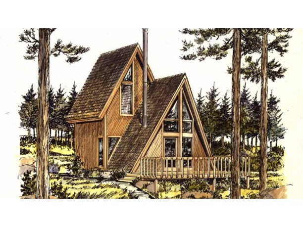

Hi!
I'm considering building this a-frame URL
Anyone build this plan? Assuming not, does anyone have any experience with eplans? How are they? If I'm building it myself, is there any need for more than one plan?

It does look cool. One thing I see, especially with a metal roof, is the chimney location in the picture. It's just asking to be torn off by a snow slide. I, too, am in the Buffalo, NY area. Whereabouts are you building, if you don't mind?

Would there really be a snow slide with a steep roof? Would it even accumulate?

Yes, believe it or not, snow will still accumulate on that pitch. I have steel on my roof with similar pitch. It builds up then when the sun hits it after a while "boom" down it goes.
And the snow that is built up is very dense and heavy from sitting on the roof's surface.

I saw that plan while designing my A-frame and it is an attractive one. Make sure they give you structural drawings not just architecturals or else you'll be guessing and making the calculations yourself.
My roof never accumulates more than an inch or two of snow before sliding and mine is comp roof approx. 18:12 slope. I think a metal roof would shed it even faster.
I don't know if you plan on doing the work yourself or hiring a crew, but beware that that's a steep roof in the drawing and by the time you are the height of the walls and your whole roof, you're going to be pretty high up there when nailing on the roofcap. I was roped in with my rockclimbing gear and I have no issue with heights but it was still precarious for me. Also, if you drop a tool its on the ground so quick. Then I'd have to spend a few minutes to climb down, retrieve the tool and climb back up...
A-frames can be a waste of space but not always. In the drawing at the top of this thread, the front section of the home where the roof comes all the way to the floor is where you get those triangles of space you can't use. Also it can be a little dark. In the back area though is where the plans place the kitchen, so all appliances and cabinets will have a vertical surface to back up to. And you have walls so you can have windows. I love the look of an A-frame, but I'm from the PacNW so its needed in some parts.
