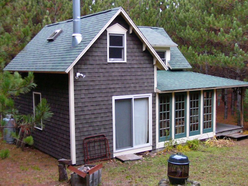

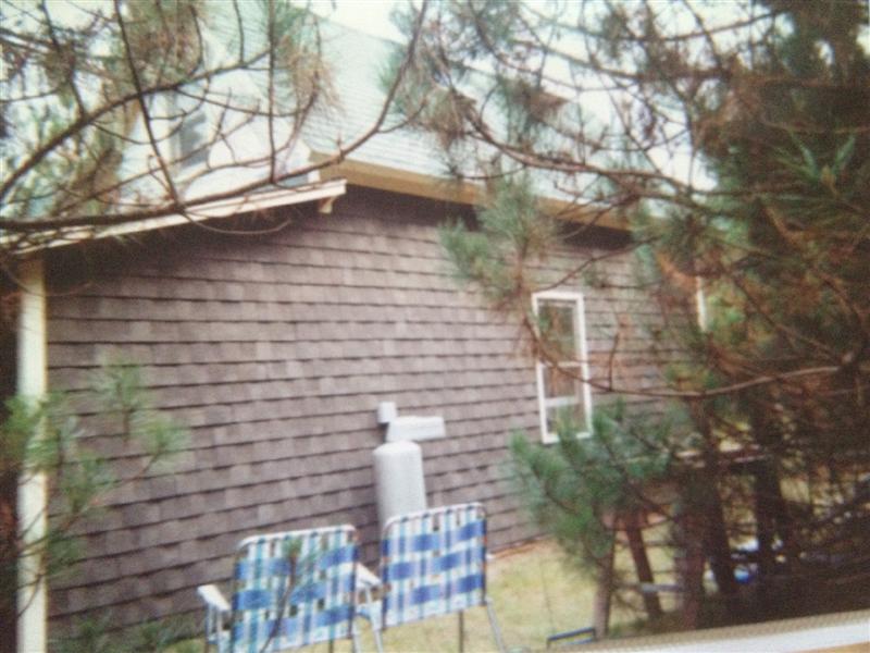

I used architectual grade roof shingles. I used the color called Weatherwood. Looks great and the life expectancy is 40-50 yrs on a vertical surface! Easy and inexpensive! cabinNov06_044.jpg

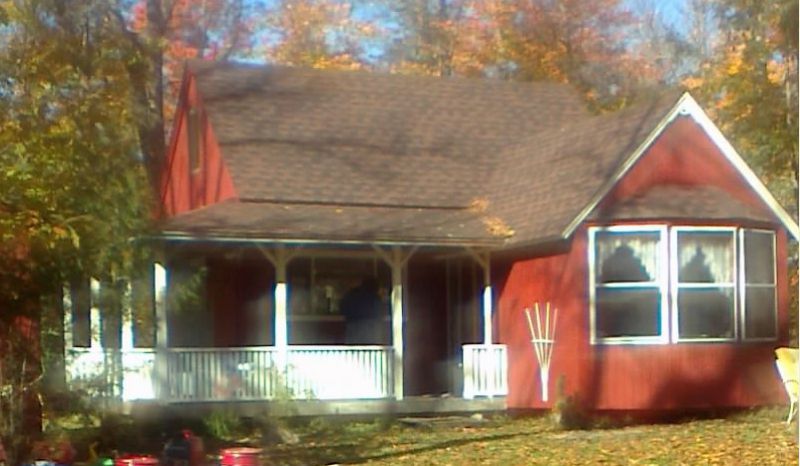

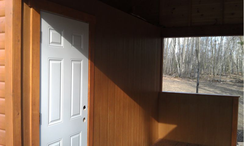

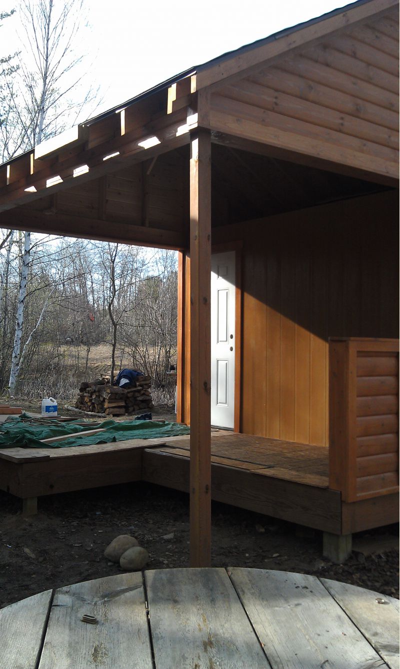

i used a james hardy cement product type siding it is hard as hell and requiers little to nothing for maitenance. it is a little less than t1-11. IMAG0518.jpg

4 yrs ago I put on those shingles. That one side of the cabin cost less than $80! It measures 10x19, almost 2 squares of shingles or 6 bundles. I thought that was cheap cosidering other siding options...T-111 is cheap but plain ugly to me. I have only seen T-111 last 20 yrs or so if that, especially in shady wet woods. My shingles should last 40-50 yrs or longer.

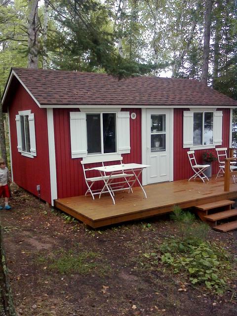

# Posted: 22 Jul 2012 12:27am - Edited by: OwenChristensen
I just used siding nails in my air nailer. Then I put a dab of grey silicone caulk over the heads.
I hear the low maintanance thing, but I don't think it has that much value. I have Southern Yellow Pine siding in 5/8'' T1-11 style on my cabin. It's 22 years old now and we are staining it for the second time. Our house has vinyl and is a powdered faded finish and is ten years old. The cement board I used should of had a backer. If you use T1-11 it is all in one. I always do my siding on the walls before I raise them. I square the frame with the T1-11 and they're done. I think they look good too.
Owen

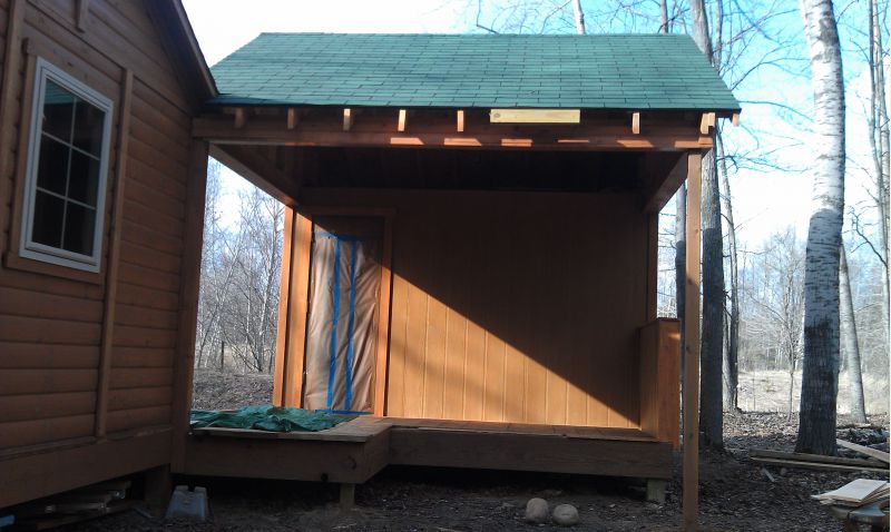

# Posted: 22 Jul 2012 11:05am - Edited by: OwenChristensen
That's a problem all right. I hate seems too. I design the building arround 4x8 sheets, but if I have to have seems, like on my own cabin, I use a z-flashing and have the joint high enough so it's somewhat protected by the roof overhang, and have cross blocking in the framing. On two walls of my cabin the porch roof starts at that joint and can't be seen. On other cabins I have covered the Z-flash with a 1x2 cedar strip with a beveled top edgeand calked to better shed and water, again onder the overhang if possible.
I havn't had the ability to choose brands of T1-11, A few years ago a brand called Royomartin looked great, but it turned out to have not been any better than the others. We have to look at each sheet when we load, no matter what brand name.
And, yes it takes a lot of stain, but that's a good thing, the more the better, 10 gals on my little cabin. $100 per 5 gal bucket. Owen

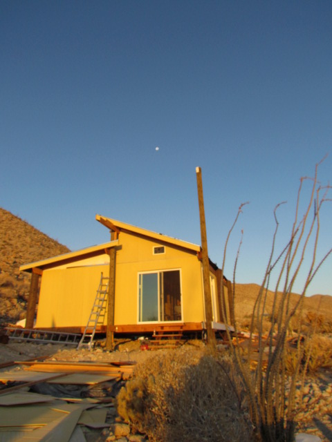

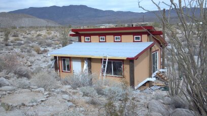

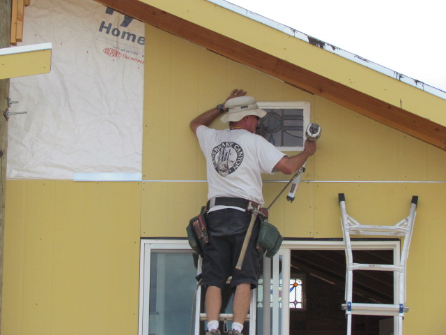

I used Hardie siding 4x8 sheets, installed over 3/8'" OSB (with Tyvek underneath) The OSB adds extra shear strength, and I just always build with it. Maybe not necessary, but it feels right to me. The Hardie siding was a natural choice since our desert cabin is meant to look good, but doesn't need to be a palace...just practical, and price and ease of install were a big factor. The special blades cut it easily , but make sure to wear a mask...... Oct._Canebrake_2011_.jpg
