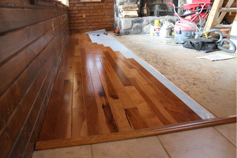

# Posted: 6 Mar 2013 04:08am
Flooring like roofing is something you need to get right. I went with hickory and did use the commercial roll of vapor barrier. Couldn't be happier with the outcome.
hickory flooring
hickory flooring
installing floor
installing floor
