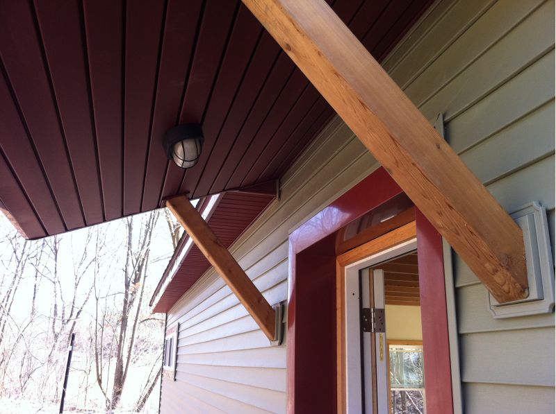

I have seen it look good and terrible. Where it can fail is in color selection and mis matching the textures. With vinyl there isn't really a great trim option. We spent a lot of extra money trying to make a wide trim around the windows and hide the j channel.
We used 1x4 and wraped it in metal stock to give it a punch of color. Then we put a smaller piece of cedar to give it one more highlight color. The coil stock in the picture came out too glossy and was replaced.
All in all. It is done. It wasn't what we wanted, but at the time of our bad contractors, time and money issues this was the best option to keep the project moving forward.
It can look good...if you spend time and money on details. And the farther away from it you get!

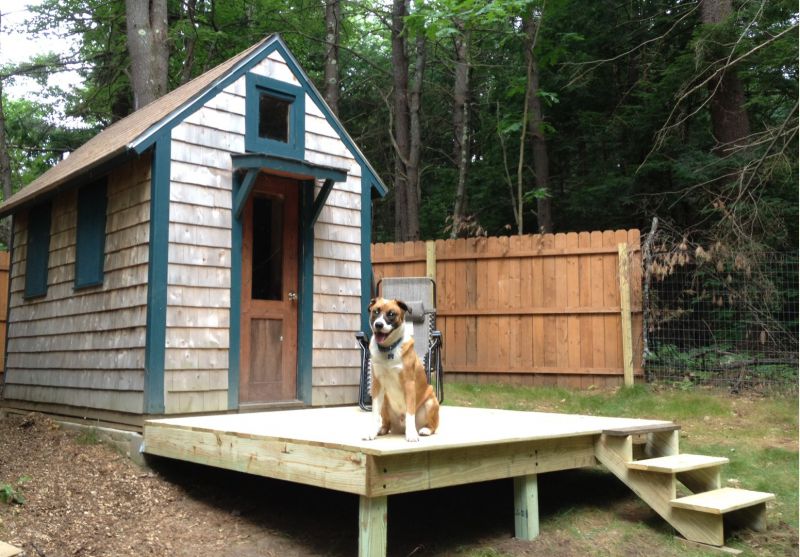

Check the grade on the cedar shakes. They come in several grades the higher (better) grades are pretty expensive. There is a very cheap grade that is about $10 per bundle. There will be some defects here and there but its usually pretty easy to work around them. It also helps to be selective at the home store when picking out your bundles of shakes.
This "shed" is about 3 years old and has never been treated and it used the cheapest grade of shakes I could get ($8/bundle I think)

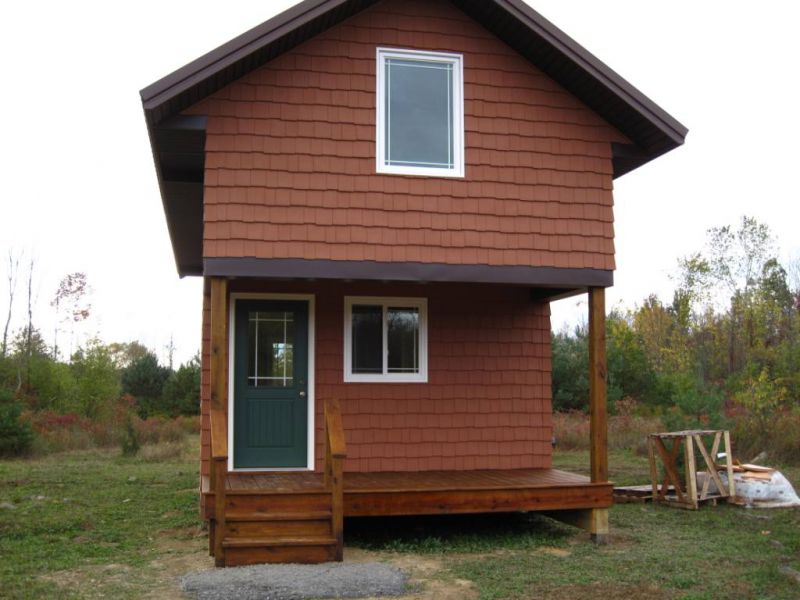

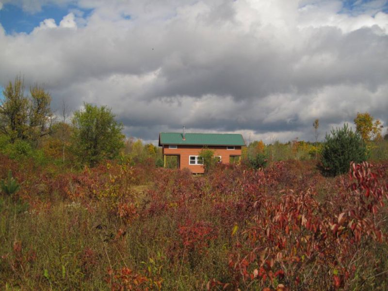

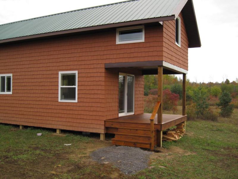

I'm currently building a cabin this summer. Hired a contractor to build the structure and my husband and I will do the the interior. I decided to go with all artificial or non-wood on the outside (except for the pressure treated porch floors. Our main home is cedar and we're sick and tired of having to stain it and have woodpeckers and bees put holes in it. I will admit that if the staining is kept up, then we wouldn't get the holes from the birds & bees though. I will post some pictures of the cabin...hopefully I'll figure it out...first time. And here's my FAKE siding...
south side
south side
Front -west end
Front -west end
Back - east end
Back - east end

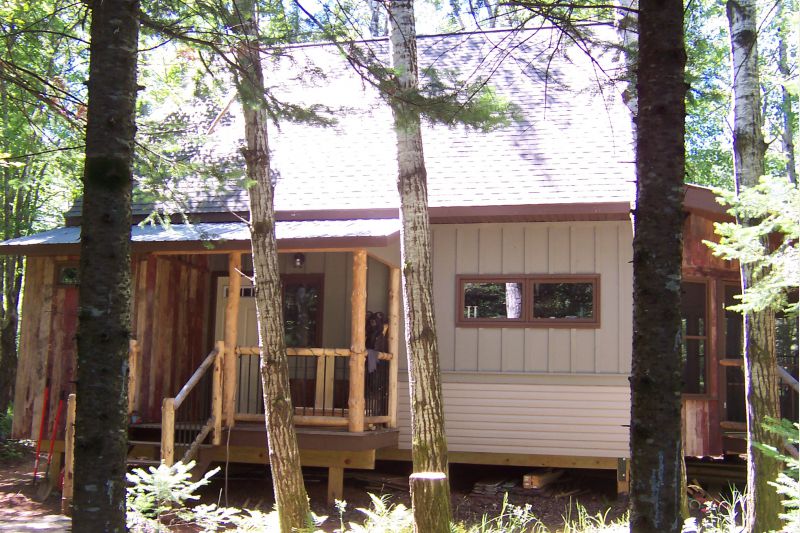

I'm new to my 1950 log cabin and it was aluminum sided long ago. I looked into restoring the logs but they were too ruined from "flattening" for the siding. I wanted low maintenance but a traditional look so I priced vinyl "cedar" siding & shakes. Not bad on a "per square" basis for just the siding but the trim doubled the cost! I guess they really make their money on the trim. What an eye-opener.
It looks like I'm going to side with 3/4" natural edge white cedar planks. Higher maintenance for sure but it's the real deal, unique, and cheaper than the imitations like Hardie board & vinyl.
