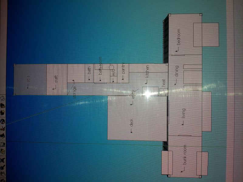

heres what im doing in utah with my 2 40 ft containers on my offgrid 12 acres. i have drawn this up about 20 times , trying all kinds of ideas. it will be solar, wind, with a backup generator. chest freezer, converted to a fridge. indoor rocket stove. solar heated water on the roof with a 200 gallon cistern and a 3000 gallon cistern in the ground as well. all l.e.d lighting. corrugated metal roofing and corugated metal and wood siding on the exterior.
container cabin
container cabin
rancid
# Posted: 7 Aug 2012 08:20pm - Edited by: rancid
i might ended earth berming a coupe sides still as well. they are corten steel , but can still rust and they really do need some reinforcement for the roof to carry dirt.

That's not a cabin, that's a house! hehehe!
