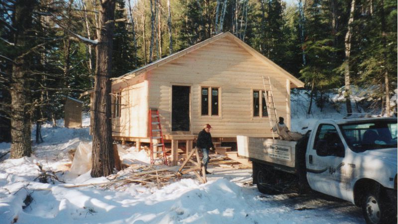

# Posted: 13 Aug 2012 02:33pm - Edited by: OwenChristensen
We put 1/2'' plywood between window header planks just to make them 3 1/2'', same as the 2x4 framing. We used to use plywood in garage door headers for a little more strenght, but most all plywood is only 96'' long. Now we use a steel plate where load bearing is an issue. So plywood does little for strenght, just a filler. As far as joints in laminated beams, plywood is little help, but another layer of 2x8 or 10's would be nice. It realy depends on where the joint is. If it's over a post and you already have two unbroken 2x8's there, it's fine. Just remember to stagger your joints. If your right in the middle between posts and you have some two foot 2x8's, use them to help out. Don't though away any short pcs., they can do something. I often run cross 2x6 or 2x8 to hold beams straight too. I'll see if I have a pic.
Enlarge the pic. and you can see a splice in the rim joist too.
Owen

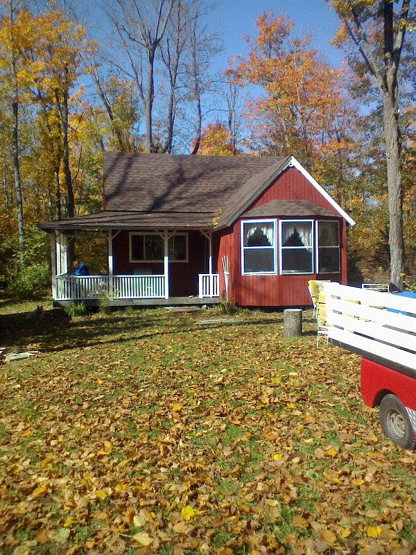

Ps if you want to see some pictures, give me an idea of what you want to build and i'll post some of the ones I've done. My own cabin is different than most that I build for customers. Here's mine.
Owen

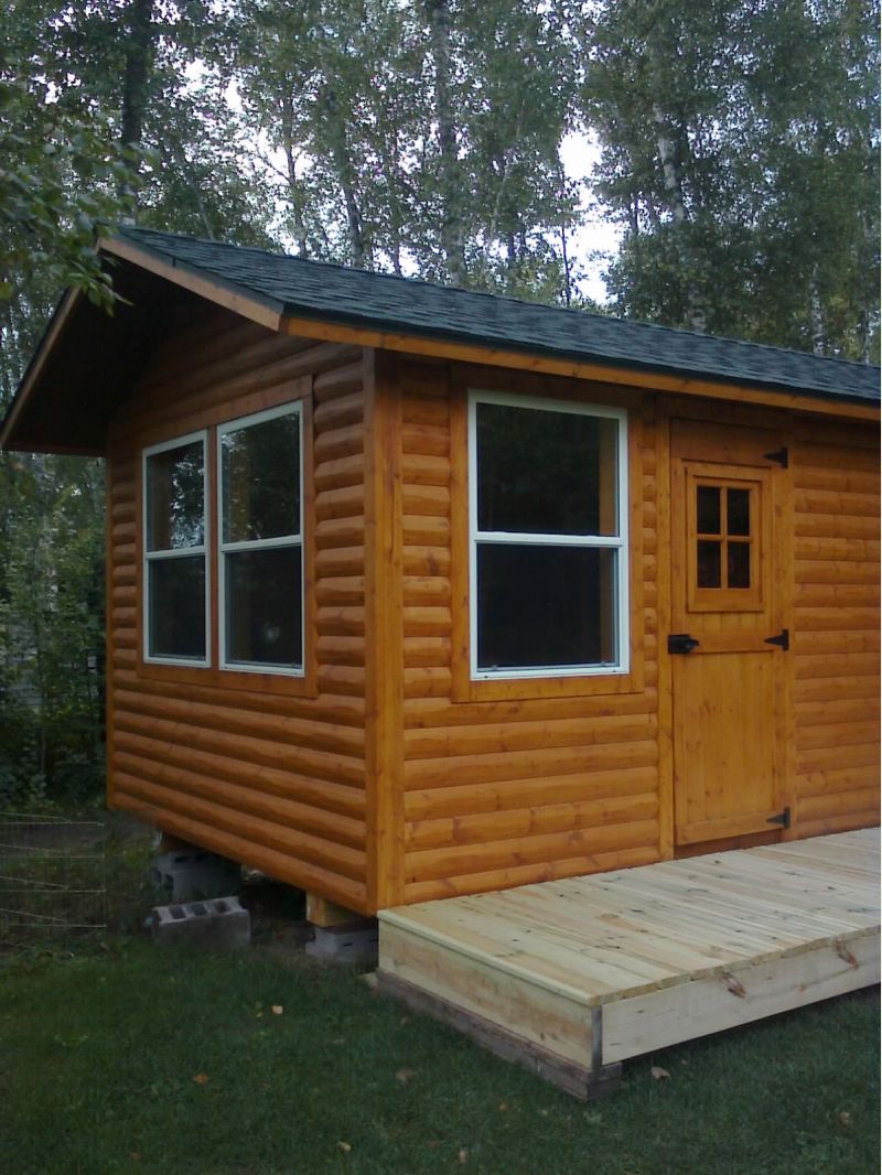

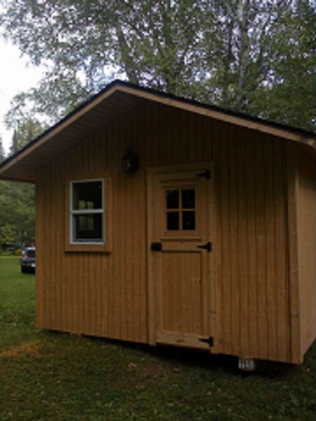

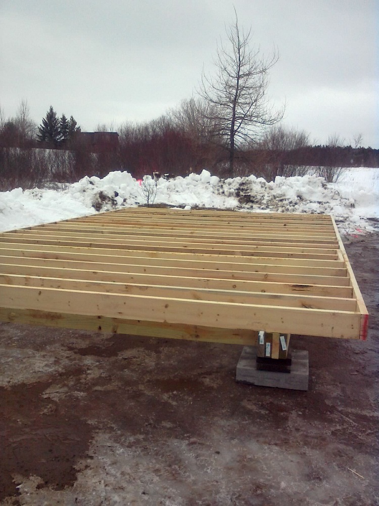

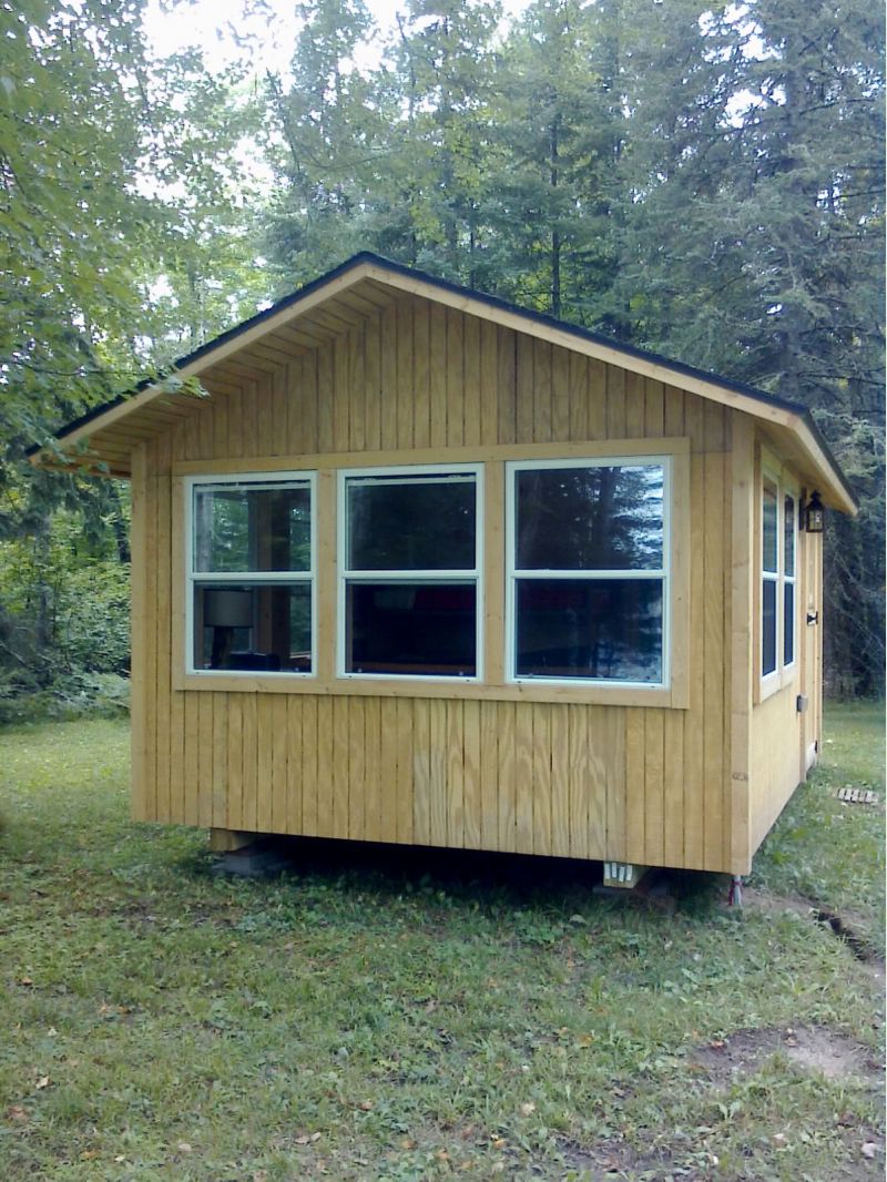

# Posted: 14 Aug 2012 11:57am - Edited by: OwenChristensen
Not too relevent, but I'll post these anyway. Maybe it's some help.
As you can see on lite building I go up to 24'' overhang. When you thing of it this will put a good tension upwards on the middle of the floor. This will compensate for smaller joists.
I wouldn't go two feet on a canin of two floors or one with 1/2 log siding. That would eventually cause a sag or distortion in that overhang. One foot is OK.
Owen
