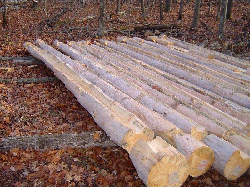

I treat with borates (penetreat + borax + hot water) right after peeling. Once the logs are on the building hit them with bleach, to remove the gray, rinse, and treat again.
Logs on skide (cut ready to go building).  They were treated before sitting under the snow.
