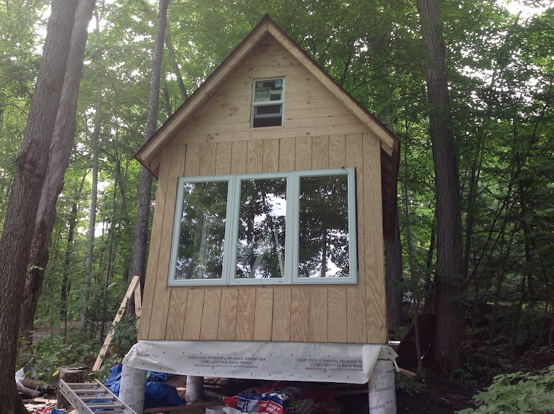

Arrrg, I'm an idiot! I installed a window today and nailed it on the inside of my cabin to the framing and then I installed tongue and groove board around it on the outside. The problem is that the window is recessed into the cabin. I believe I should have installed the window on the outside of the framing. I can't undo it, but I need a way to make sure that water doesn't sit between the window and the siding. Is there a solution?

# Posted: 14 Aug 2012 08:23pm
Here is a pic of what I did. I am talking about the window in the upper part of the cabin.... thanks for any ideas!
# Posted: 14 Aug 2012 08:36pm - Edited by: OwenChristensen
I would guess a jam extension to fit will be fine on the sides and top. Maybe a metal flashing on the bottom.
Owen
# Posted: 14 Aug 2012 08:45pm
If you flashed it correctly with paper before installing, then all you need to do is install jamb extensions as Owen said. Rip a piece of wood on your table saw that extends beyond the T&G 3/4" (attach with finish nail gun), then use 1x4 casing to enclose the whole window as typical. Silicone the top and sides, leave the bottom open to allow moisture to escape.
johng
# Posted: 14 Aug 2012 09:07pm
Remove it, cut the nailing fins off and then install it as a retrofit window...trim like the rest.
mojo43
# Posted: 14 Aug 2012 09:49pm - Edited by: mojo43
I did flash it. I will install a flash extension, thanks!
