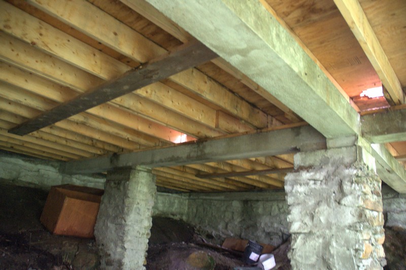

Last year i bought a small piece of land that already had a platform and foundation build on it. It's made from rock and concrete and seems to be very solid. I just found out that its actually been there for more than 10 years! Although it has passed the 'test of time', there was never actually a building on the platform so who knows how much weight it can actually hold now.

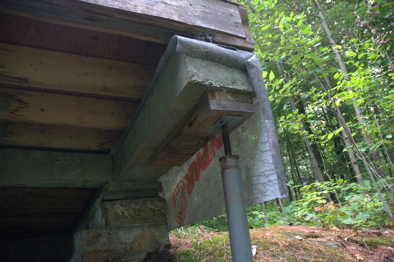

My main concern in the 2 foot overhang that is supported by what looks like, temporary steel columns. I doubt i could remove them and build a solid column... I'm thinking of building a form around the current footing to increase it's size and engulf the bottom of the steel pole. Then build another form about a foot high around the pole and pour one layer at a time, making my way all the way up to the concrete overhang. Then i have to figure out how to pour under the overhang!

foundation
foundation
The overhang
The overhang

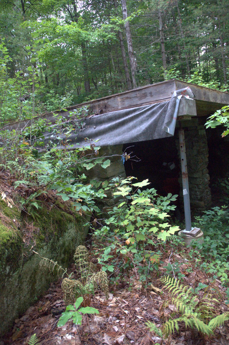

top of the overhang
top of the overhang

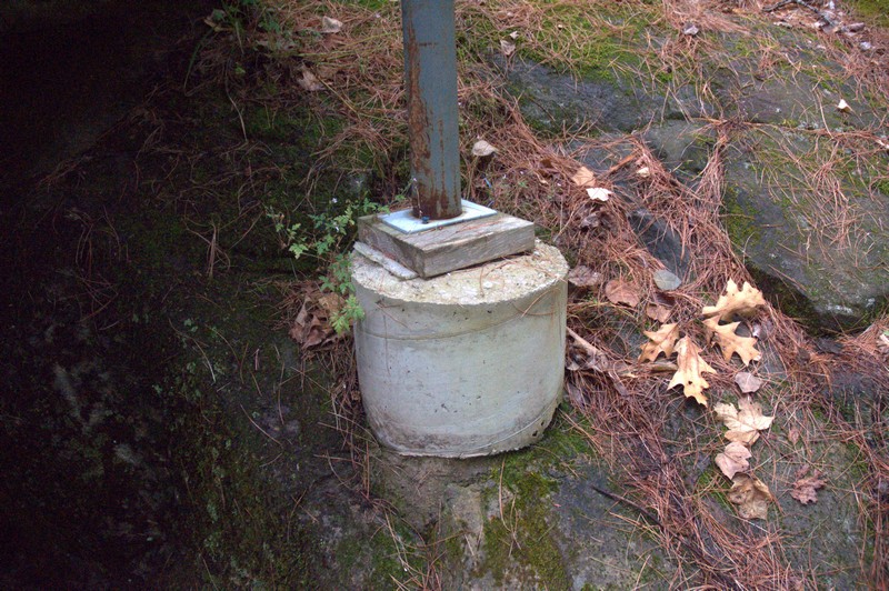

the small footing
the small footing

That footing does not look like its even buried. Do you have a frost issue where you are?
I would buy a temporary column similar to the ones in use and install it next to one of the footings. Remove the existing column an dig a proper footing. Install a treated support beam of the correct size when the footing is complete.

The whole platform/foundation is actually built on a giant rock... so i don't think it needs to be buried.
What are the chances of that concrete overhang to break off if i took out the pole?
