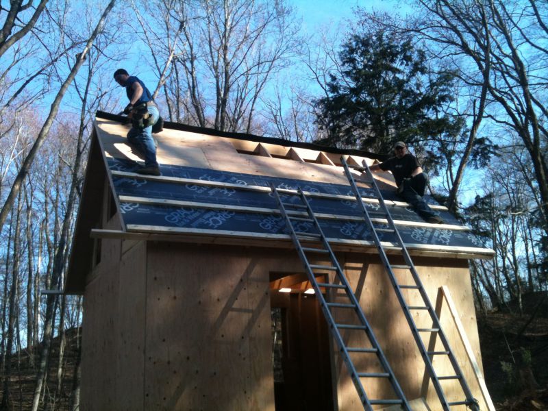

  Mtn Don, I think one reason to purlin on top of sheeting is to give more structure for the screw to hold onto (more than 1/2" of osb).
  Here's how I did my 12:12 pitch...
  sheeting (left a few inches at the top for the ridge vent) ice and water all the way the sheeting  purlins metal
  I think as long as you're not using standing seam metal, but using polebarn metal (with ridges for airflow) you'd be okay.
