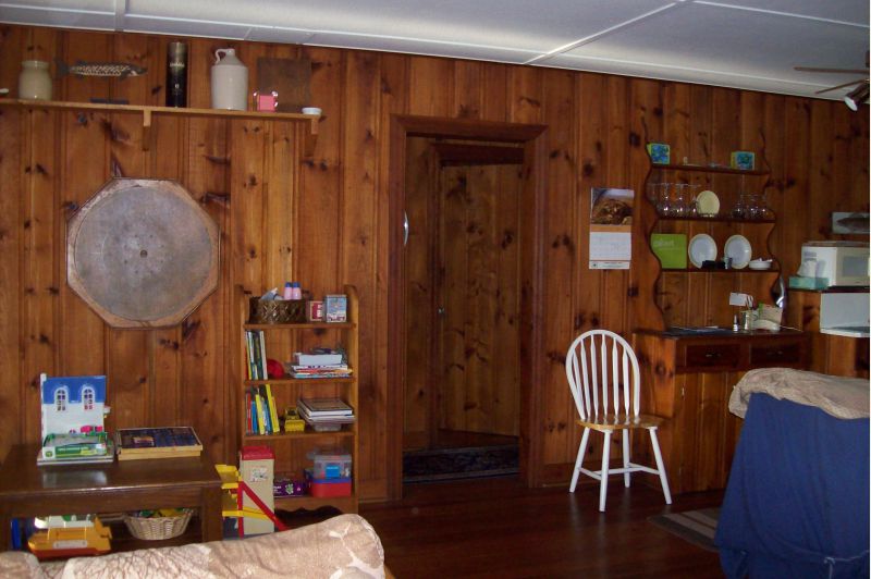

My cabin is over twenty years old without any finish. And I'm fine with that. I'm more afraid of a finish that peals or flakes off after ten years, than a slight darkening of unfinished wood. As far as mold, unless you do something like a lot of laundry or have a hot tub steaming, I can't see any issues there. Most of our cabins are dryer than our homes.

Our cabin is all done in shellac . Floors and walls. That is the original finish after 60 years . I still make all repairs with shellac and turpentine. they are one of the few all natural ways of protecting wood i gess that appeals to us..
shellac 60 years
shellac 60 years
