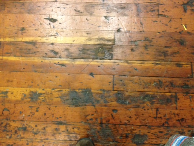

FYI: Here's a pic of the floor of my shop. I weld all the time over it, the sparks dropping to this wood floor and rolling all around. It's Fir, with Varathane, and doesn't appear to be bothered by sparks. It has that old patina, but looks cool (I think).
Sometimes if it's going to be a longer job, I lay down a couple 1/2" cementboard sheets. The heat in any one spot is only for a few minutes, it's not like protecting a wall from an overheated woodstove for 4 hours. If I have to do anything where there's some real HEAT, I go do it on a concrete slab. Or if I have a longer job, where I will be welding a lot close to the floor, I go to the slab. I also have a fiberglas welding blanket (from Harbor freight) that I drape to block sparks.
I've had this shop for 6 years now. I don't worry about it much. The building was an ornamental iron works, that's where all the original scars on the floor are from, it looked like that when I got it.
It's 3/4" T&G fir ontop of "2x4s on end", so the floor is 4 1/4 inches thick, SOLID WOOD. In the old days that's all they had for fire protection, wood so thick that "burn-thru time" was a long time. My walls are concrete, and some interior are 2x4s with 5/8" drywall. The floor is original, probably about 70+ years old now, has had plenty of time to contribute to someone's Darwin Award.
My point is, don't worry so much about gathering all the right materials. It's not a big deal to protect a floor for occasional welding. Concrete floor is great, and almost any other floor, even plywood can be easily dealt with. Don't worry about your posts. Or just wrap them with sheetmetal or even drywall. Drywall is not fireproof, but it withstands fire for awhile, and thicker drywall has longer resistance. Drywall is the most significant fire protection since neighborhood fire departments. Drywall is not ignited by sparks, or a flailing torch. Worry more about flammable liquids, cardboard boxes, paper, rags, tarps etc.
Whenever you start to worry too much look at my floor pic and think; "hey this was used commercially for ornamental iron manufacturing, for 30+ years". It is obviously the WRONG kind of floor for commercial steel fab but it's stood the test of time. Either it's tougher than stupid, or stupid didn't work there but I bet it had all kinds of workers since the '30s when it was built.
