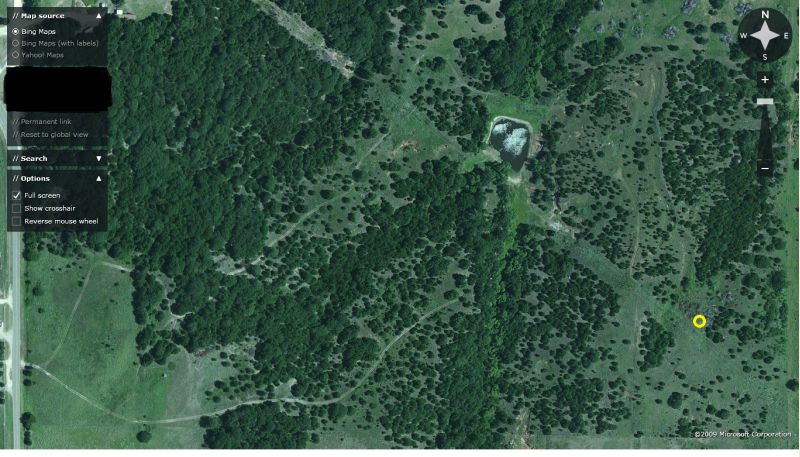

Well, it's not a cabin. I've had a setback financially. Still, it's a build.
I'm building a permanent deer blind for my 80 acre ranch. The attached photo shows the location on an elevated ridge. It'll face NE between two feeders. The best part about the location is the ridge drops to the NE and everything east of the NS line goes into shadow at least 30 minutes earlier than flat land. Deer move earlier providing an extended prime shooting time.
It'll be small but elegant. I'll put it on concrete blocks. It'll be 4 X 6 feet with a 2 X 2 entrance deck (!) to wipe your feet on. It'll have a steel door with a dead bolt/knob and a 3 x 4 single hung window. I haven't decided the height but it'll have a shed roof with corrugated galvanized steel and Hardieboard siding. We don't build things that won't last.

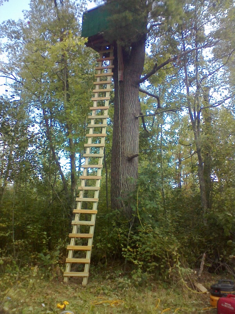

Owen
a tall one
a tall one
mrmiji
# Posted: 9 Sep 2012 12:26am
Oh, my!. I have to tell you, I have over 4000+ hours of flying in military aircraft but I couldn't climb that ladder. The new blind will however be located on an elevated position so I won't be afraid but I will be shooting downward.

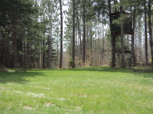

# Posted: 9 Sep 2012 09:39am
I've shot a lot of deer from that tree. I love those big lone pines. I have many stands around my land. One is all enclosed and insulated. I think it's too claustrophobic.

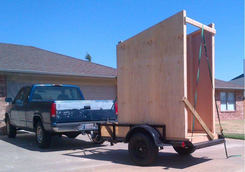

# Posted: 11 Sep 2012 10:08pm - Edited by: mrmiji
It's going together on the trailer. I have the roof out of the photo and need to build the other two ends for the door and the window. After I get it to the ranch, it'll get tar papered and skinned with galvanized corrugated steel.

# Posted: 13 Sep 2012 09:33pm
I'm running a little short on luck today.
For months we've gone without measurable rain in NW OK and I choose to build the week it rains 1" with more to come. Though I was able to get the window and door walls along with the roof under cover, the parts in the photo are in the rain. I checked 'em tonight and there's some swelling/bowing of the wall panels but it's all still together.
If it dries enough for the 55 mile trip, I have three people going out with me to install the thing.
Also, Lowe's didn't have an outswing door in stock so I took the 32" inswing without thinking about clearance on the shed roof. There were some anxious moments at that realization until I knew I was good to go.

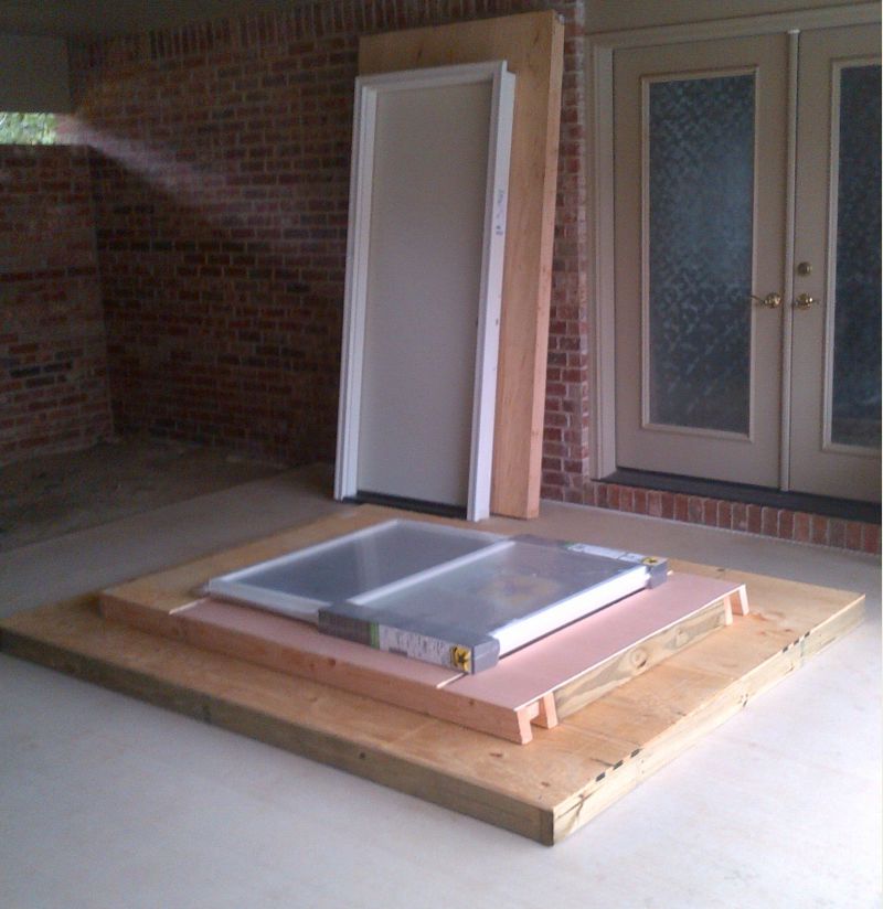

mrmiji
# Posted: 14 Sep 2012 01:28pm - Edited by: mrmiji
The parts on the trailer don't seem to be damaged.
The photo shows the door and its wall leaning against the patio wall and the window and its wall resting on the roof on the ground.
And, yes, I don't know anything about framing.

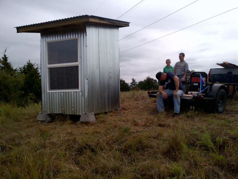

mrmiji

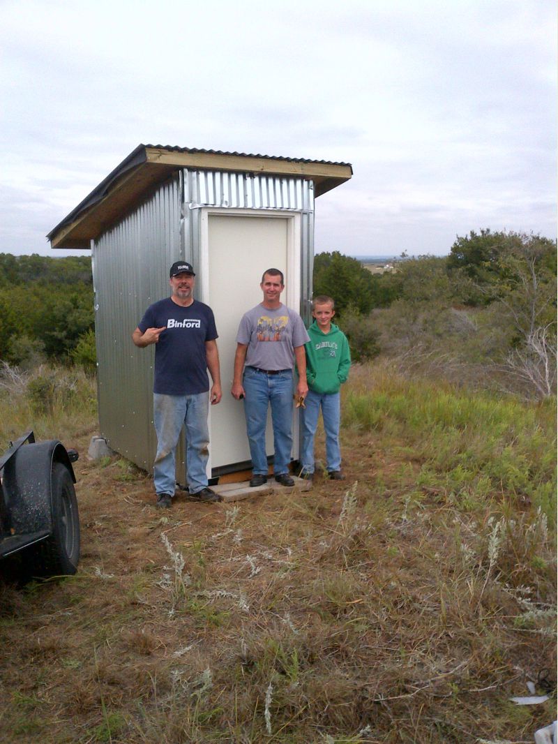

# Posted: 15 Sep 2012 08:01pm - Edited by: mrmiji
I have to paint the door but it's otherwise complete.
