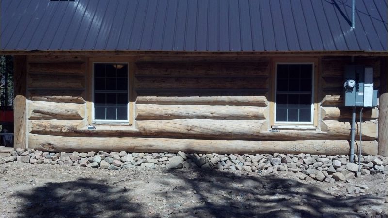

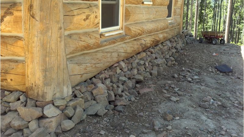

Montanan
# Posted: 18 Sep 2012 01:40am
We have a log cabin on piers and ours is pretty big- 22x26'. It works fine in our rocky terrain. We didn't even insulate underneath. We just put treated wood skirting covered in roofing paper and stacked rocks around the perimeter to make it look nicer.
TomChum- LOVE your cabin on rocks and plan to steal the idea when we build our small guest cabin (also log) on our property!
Montanan
# Posted: 18 Sep 2012 01:42am
Finished (for now) perimeter:
