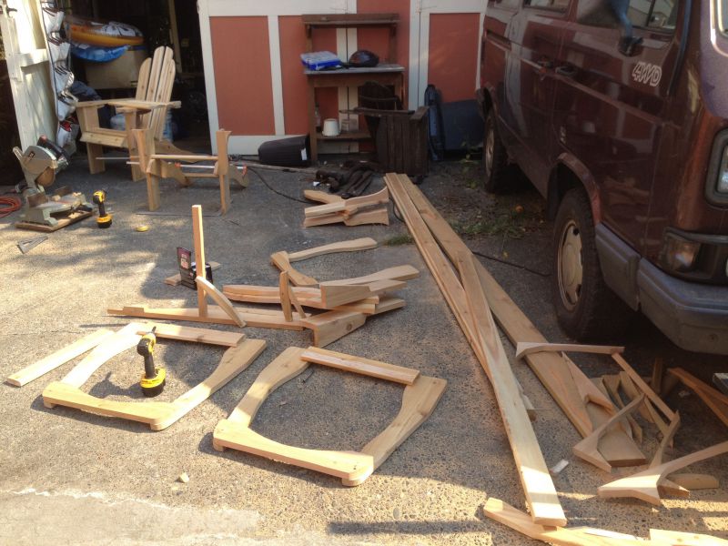

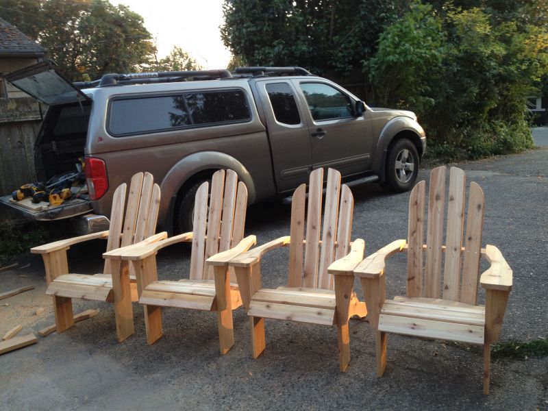

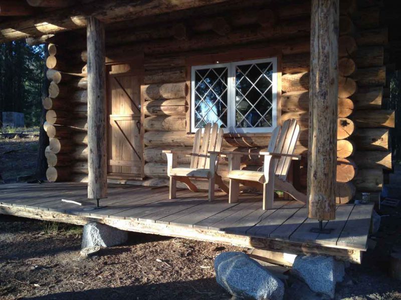

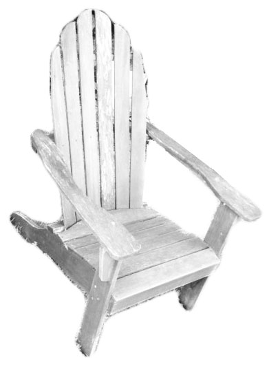

# Posted: 27 Sep 2012 04:24pm
Maybe make some chairs? Adirondacks are made fro flat patterns. There are lots of plans, easy to find on the web.
I used a chair from a dept store as a pattern, diassembled it, traced the parts and made 4 more chairs out of Cedar.
