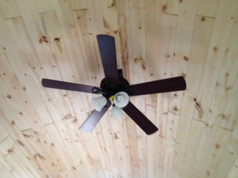

You will have to post more pictures of your cabin. The ceiling looks great! I love the knotty pine. Did you use plain boards or is it T&G? Did you bevel your own ends?

Wow, quick respones around here! The polycrylics is what locally was suggested to my because of the non yellowing and low odor. Its going to be a lot of work, i will post some other pics. Its the entire cabin, as i say to my wife, its the sea of pine! Thats how she wanted it though. And the material was tongue and groove and yes i did cut every one of those god forsaken bevels! Again alot of work!

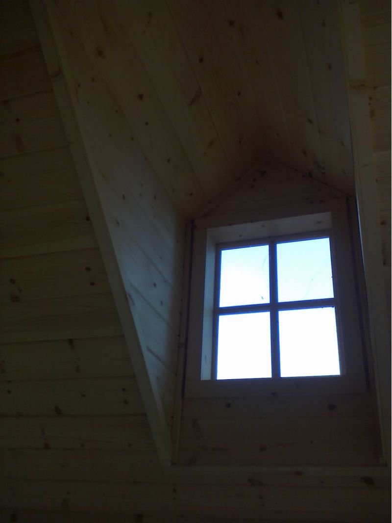

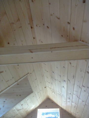

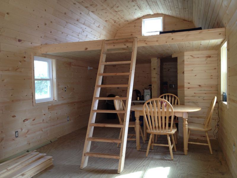

trying again to add a pic of the inside.

Dillio187
# Posted: 19 Sep 2012 02:37pm
sweet, I like it!
TheCabinCalls
# Posted: 19 Sep 2012 03:56pm
Very cool place!!
