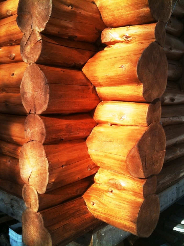

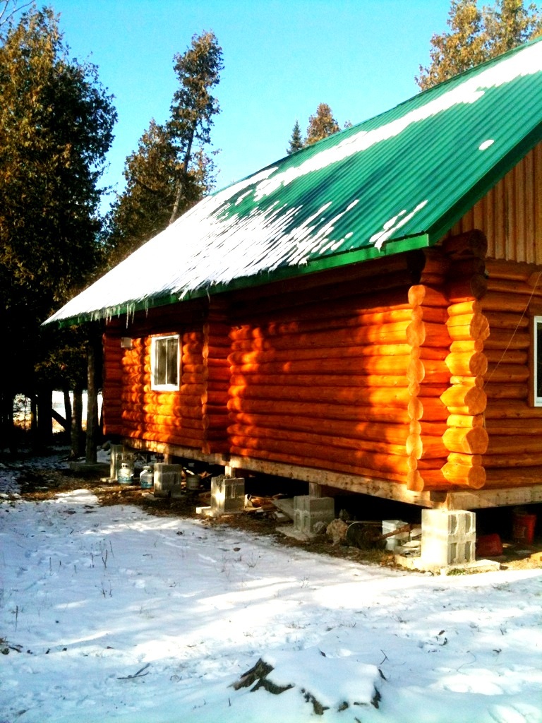

# Posted: 25 Sep 2012 11:46pm
How about this? Hand scribed in white cedar.
