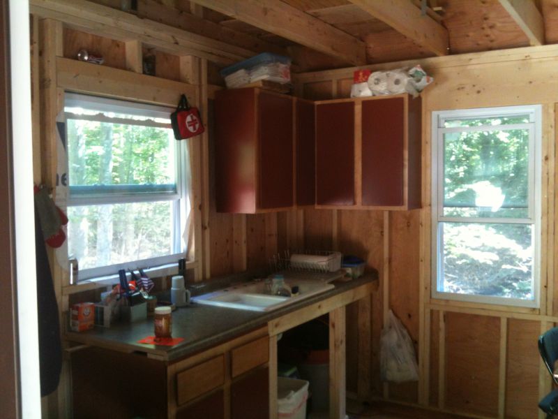

kitchen area
kitchen area

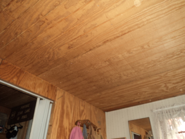

# Posted: 21 Oct 2012 14:54
Luan ceiling pic
