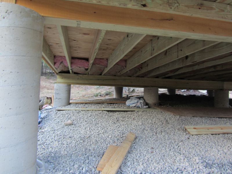

Our cabin in central PA has "hardboard" screwed to the bottom of the joists to protect the floor insulation and keep critters out. This was easier to work with a cheaper than cement boards. We are getting water stains on the seams at the perimeter where water runs down the side of the cabin, underneath the deck band board but outside of the Tyvek (we took off the lowest piece of cypress siding and added the decking after it was mostly framed). I took a piece off last weekend and the insulation is dry as it is above the hardboard, but it makes me think we might want to ventilate the space some - like small round soffit vents. Or should we ignore it, keep a watch, and if need be in the future replace it and fix the water - which would require some major adjustments in my opinion? It can be cold and windy there, and we do have gravel over plastic on the ground underneath, which ranges from 18" to 4' off the ground. I will add a picture if I can find it.
Before hardboard
Before hardboard

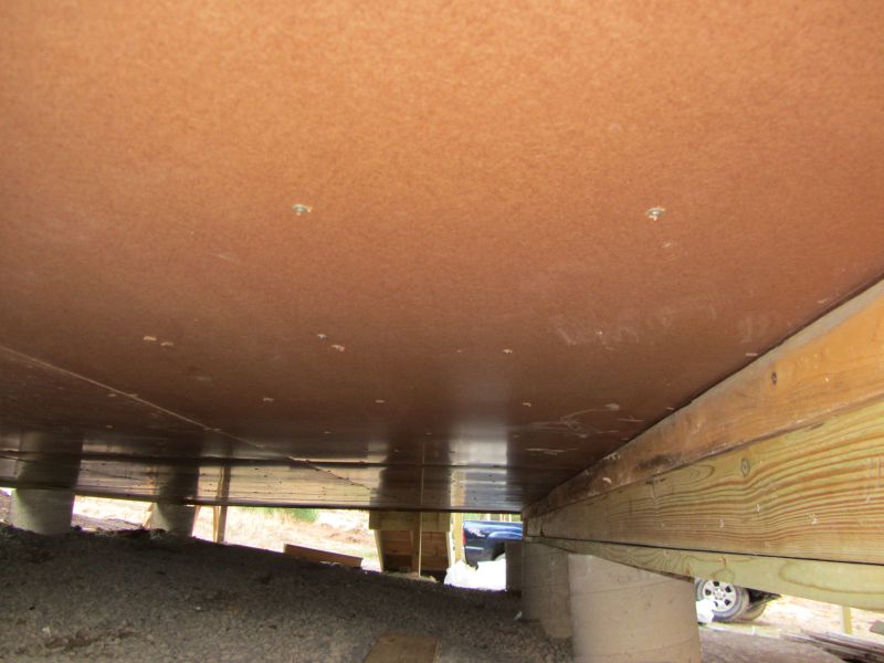

The other picture did not make it - here is the hardboard shot.
Hardboard installed
Hardboard installed

FishPCreek
# Posted: 23 Oct 2012 09:56pm
Thanks for the comments. I did pull back a sheet of the hardboard at one of the most stained parts and the insulation was dry underneath, and in fact was about 2 inches above the hardboard, so that any water that may have been sitting on the top would not have touched it. The water seems to be running down the outer band board and then "rolling"from the bottom of this to the hardboard which is mounted just inside this band board. I guess with the airflow under the cabin, as long as the insulation above this hardboard stays dry, maybe I will not worry about it.
