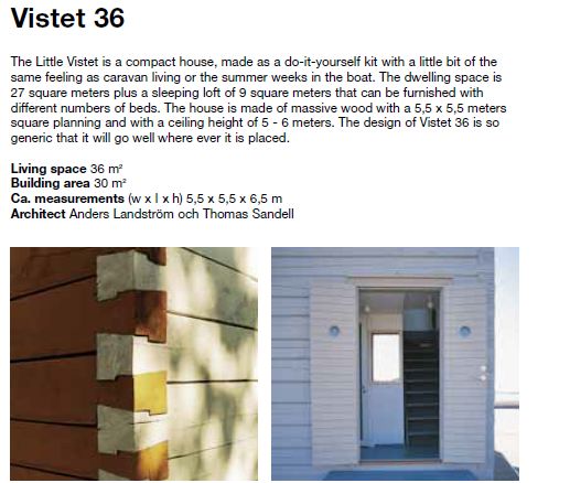

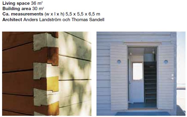

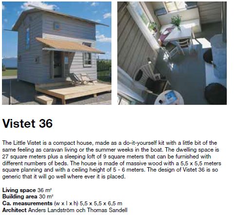

Take a look at the pics. I think it said this is supposed to be a do it yourself project. How in the world would you cut the ends of those timbers to fit like that ? I cant even figure out how to make a jig for the regular interlocking Tennessee cabin style log ends ? ? ? logend_connect3918..jpg

# Posted: 27 Sep 2012 05:57pm
Lots of chisel work most likely. Ya' probably get real good at it after the first teo or three dozen.

# Posted: 28 Sep 2012 01:31pm
This looks like a 1/2 dovetail joint where the builder cut in an extra locking notch. It doesn't take much work to cut a dovetail. Layout a minute or two, a rough cut to the line with a chainsaw and then clean up the joint with a slick. You can cut a dovetail in about 10 minutes. So as long as you have the timbers available, you can build very quickly.
I prefer the look of a the dovetail the extends a few inches beyond the wall.
Here is a link that shows how to use a simple template to layout the dovetail.
http://peelinglogs.blogspot.com/2011/06/12-dovetail-layout.html
