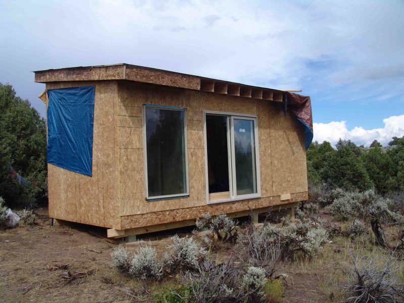

Building is not rocket science...but it does take some skill and attention to detail. Being a remodel carpentry for the the better part of the last decade, I have seen many projects that were "owner built" and some were pretty scary if not outright dangerous. Prior to you project, you might want to pick up a decent book on construction and building techniques, there are a number of good one out there. Illustrated ones are much better ...most beginners need to see diagrams of how things go together.
Electric and Plumbing are likely to be be your biggest challenges ...as cabinbuilder said. Permitting... if applicable.....and ties to these could easily break your budget. ( tieing in to a septic system is pretty involed) I built a simple storage shed a few years back for about $1200 (no windows and a site built door) and used it as a baseline for estimating our larger cabin's budget...materials to date for our 200 sq foot are about $3500...but does not yet include, siding, wall insulation or any interior finishes...Yes you can build something for $4000 but it will be smaller than 200 feet....
