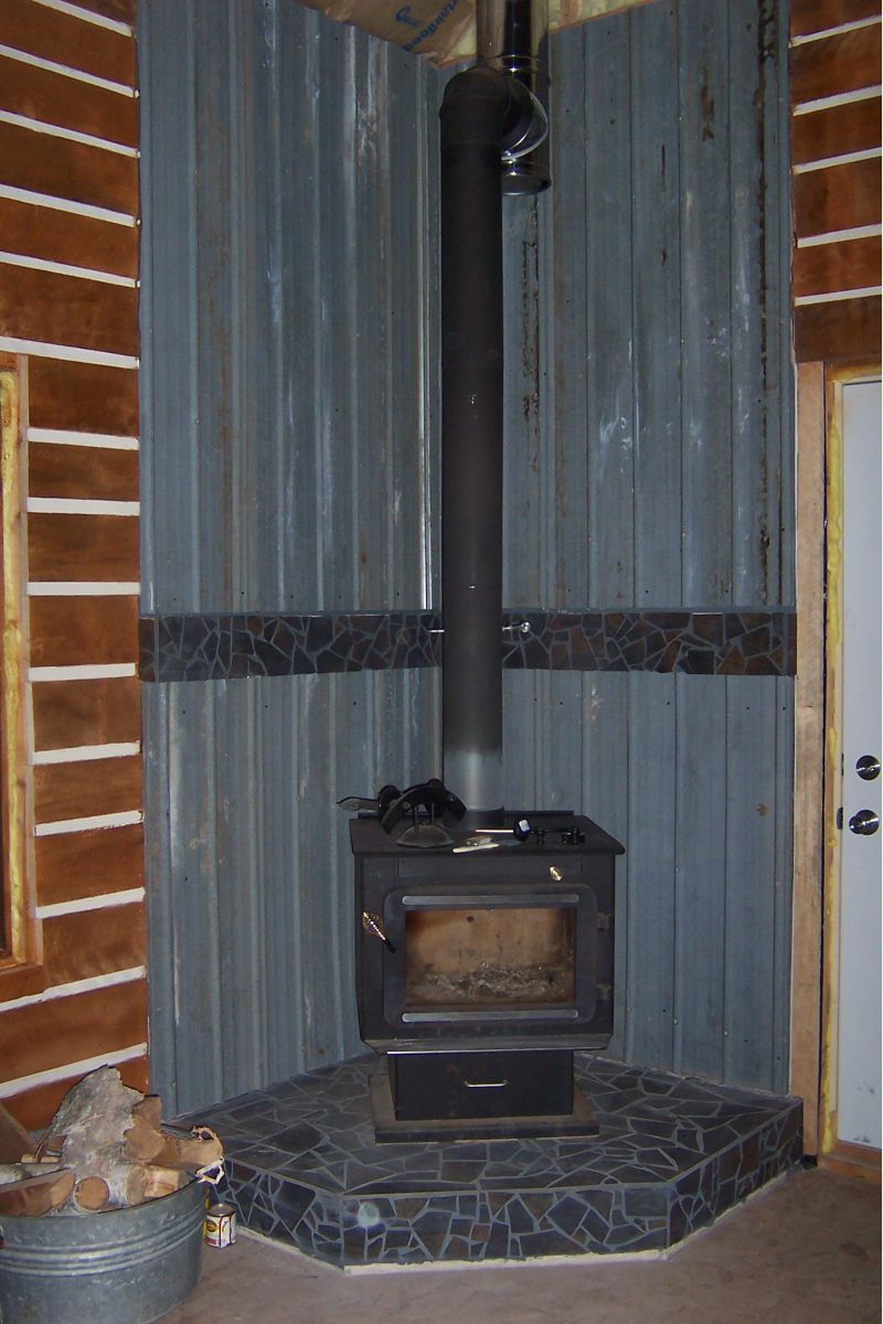

I take the lower section off. It also has a couple swivel elbows to get around the rafter, so needed to come off anyway.
Guess I should have mentioned that before,....
The lower (or somewhere inside under the roof jack/support)usually has a slip joint, so isn't too hard to take apart. You need enough room to get the rods into the pipe and work them in any event.

On our stove chimney we have an elbow also-so that it went through the roof at a more favorable spot. After the elbow it enters the stainless steel portion to continue it's way outdoors. The stainless portion has it's own clean out opening at the bottom of it. So basically we clean the "inside" pipe and then the "outside" pipe.
