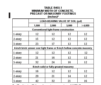

GomerPile
# Posted: 22 Oct 2012 06:50pm
There is a table in the IRC that shows footing needed roughly twice as large as the sonatube being used. Dig hole to correct depth and fill the bottom with 8 inches or so of cement. Put a piece or two of rebar in there to keep from shearing the pier during heavy frost.

GomerPile
# Posted: 23 Oct 2012 12:04pm
Back at work here's the chart I mentioned. Its only a guide....there are a bunch of exceptions in the code. Its basically 16 inch pad for an 8 inch tube in the worst soil conditons.
