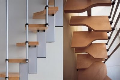

For those of you (like me) that have been looking for solutions that will give you a good looking, usable set of stairs that aren't downright scary, check this out.
http://www.stairplan.com/spacesaver.htm
Montanan
# Posted: 24 Oct 2012 04:12pm
This is my favorite design from them. I'm considering it for an attic room we might do at our home.

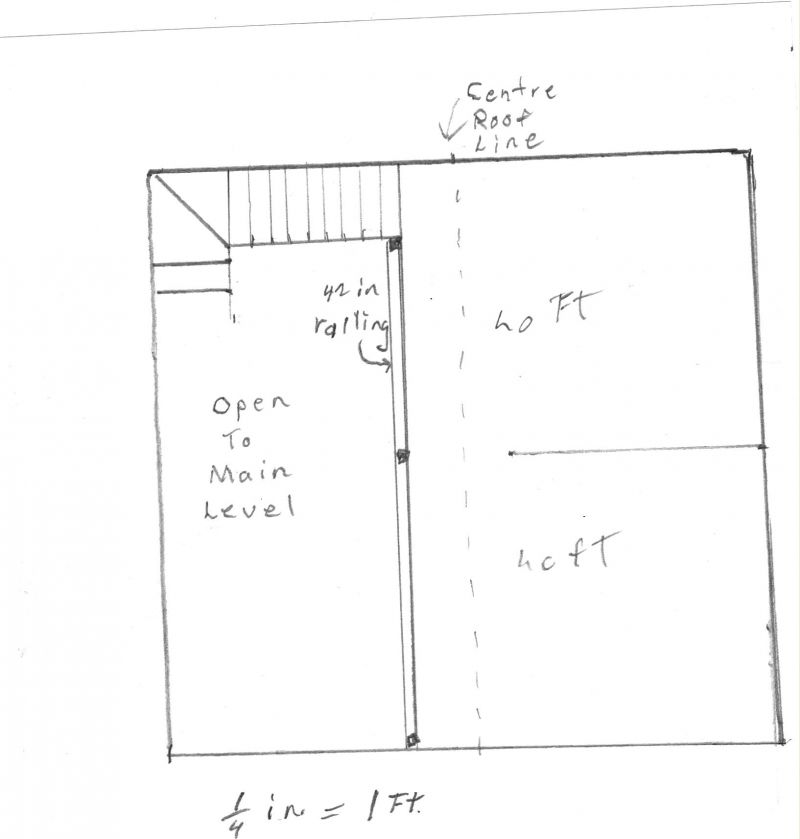

# Posted: 24 Oct 2012 09:48pm
Put this set in a 8 x 13
10 in rise x 10 in run 20 in tread

# Posted: 11 Nov 2013 01:30pm
Hey Just, I like your stair design, do you have any more pics of it? Is it in a 4x4 space?
# Posted: 11 Nov 2013 02:00pm
I believe they are 20 in wide with a 10 in. rise and a 7 in. tread .There is only a 7 ft. ceiling in the cabins main floor. I will look for more pic's but i'm not sure ,I no longer own the cabin, sold it in 05.

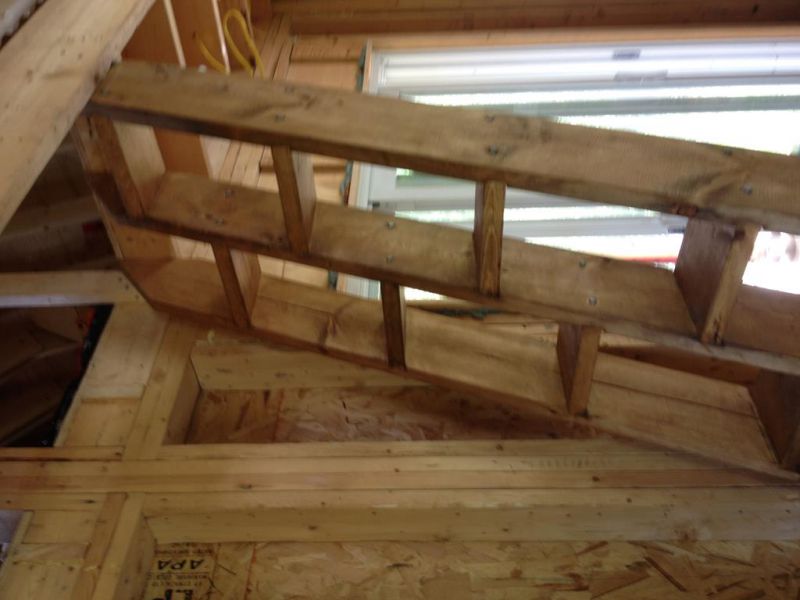

# Posted: 12 Nov 2013 10:27am

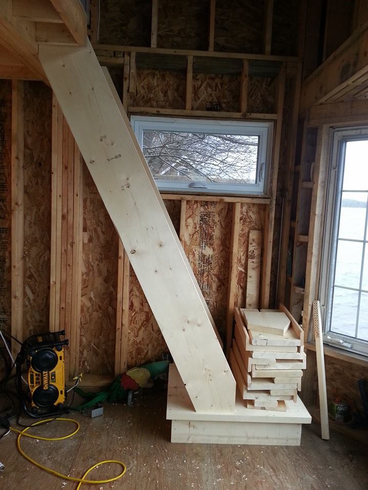

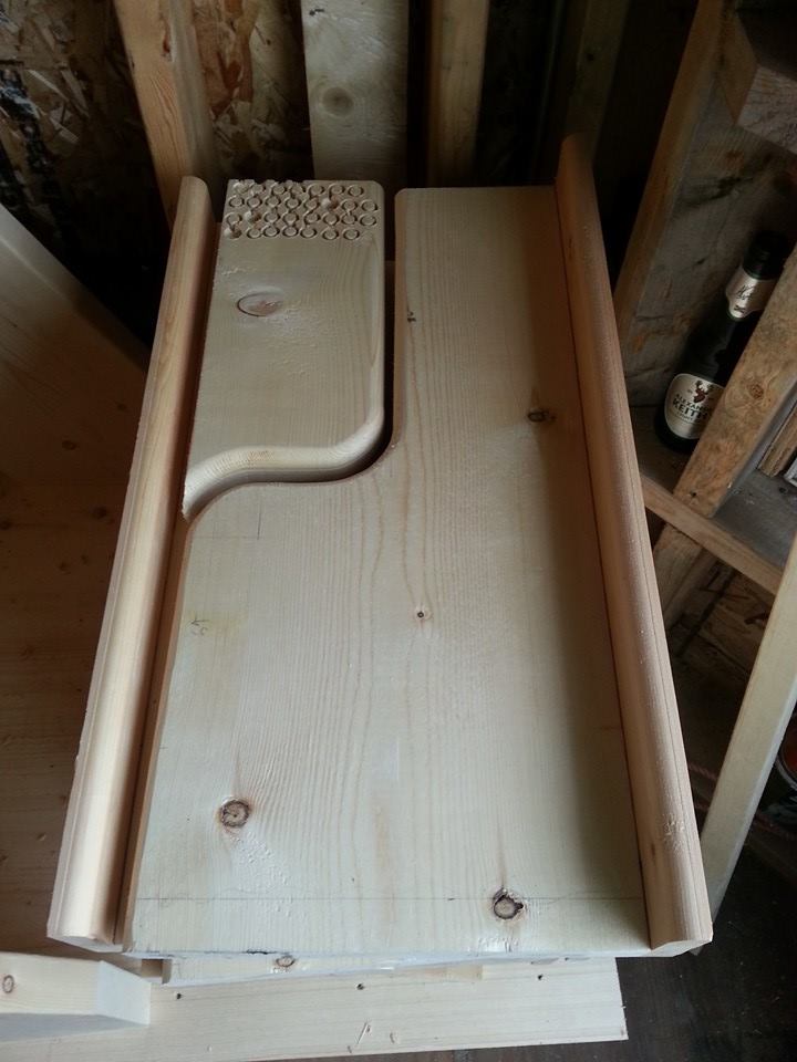

In the process of building a set right now... here is where I am. Just need to assemble them now.
11 stairs, plus the platform. 64 degrees. Rise is about 7 1/4" per step. 27" wide total, 24" treads. Made from 2"x12" lumber.
Should be very easy to walk up/down.

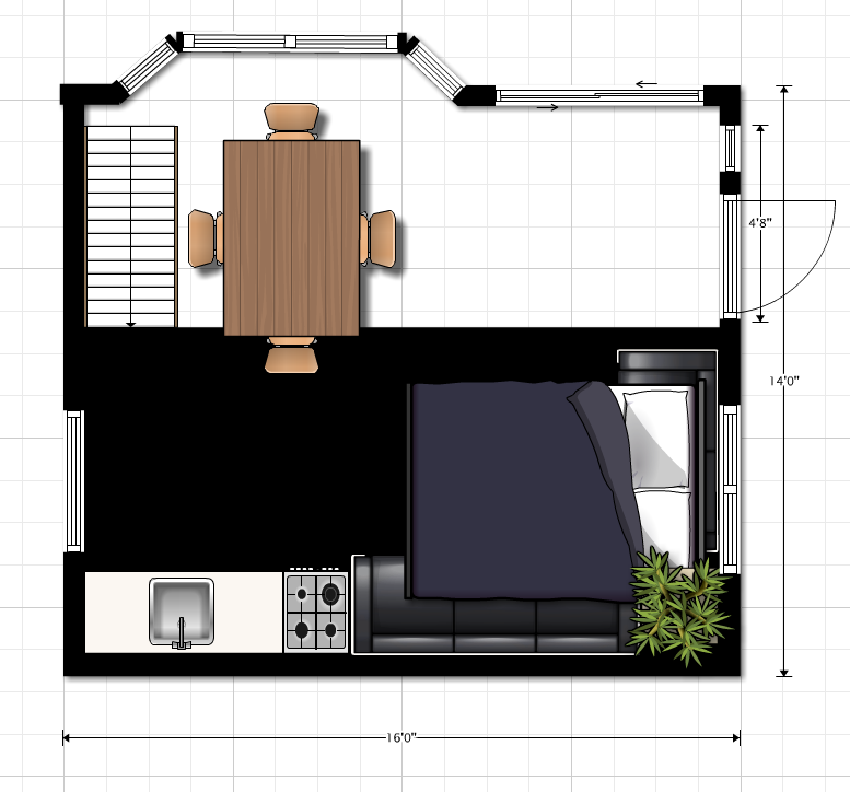

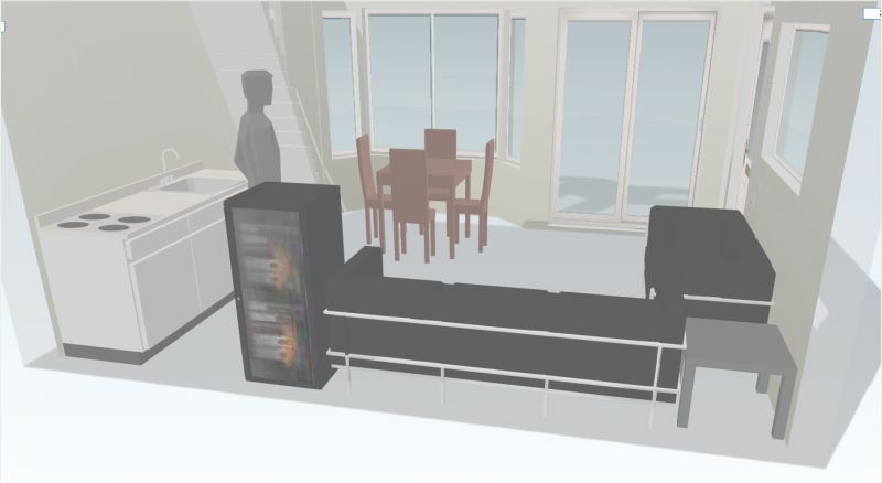

Hey SubArcticGuy, look at my floor layout in this thread;
http://www.small-cabin.com/forum/6_3652_0.html
Mine is only 16x13, so you could so something similar, but even better (no need for the landing area). My loft is 15.2'x7.5' (actual floor area)
Here is the floor plan for reference, but there are more details in the thread.
From above
From above

cbright
# Posted: 12 Nov 2013 02:19pm
Ahh... never mind, that might not work for you if you oriented your roof 90 degrees to the way I did. I put a lot of thought into how I built my loft (which is opposite of what I normally see) for just this reason and because of my views/water access.

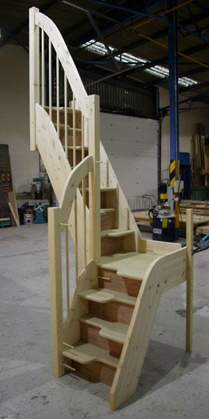

# Posted: 12 Nov 2013 07:09pm - Edited by: rockies
A lot of building codes mandate a maximum rise of 7 7/8" for a staircase tread. One way to get around that would be to try an "offset" staircase design, where the treads only run halfway across the width (which, now that I look at it, is exactly what is shown in the first picture lol) Still, I've already typed this, so.....
Offset stairs
Offset stairs

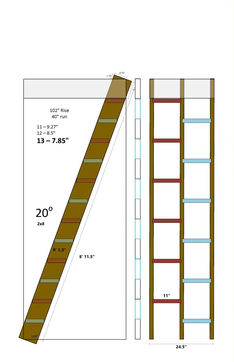

We have been really happy with our alternating tread ladder into our loft. Less by design and more by luck it fitted nicely between the two large deck sliding doors and runs into a cutout in the main loft (the loft extends from over the deck into the cabin by 2').
I love cbright's design and workmanship (posted above) but for those less skilled you can make alternating tread ladders using 3 stringers as described here: Fine Homebuilding. below is the plan I used (naturally only suited for my rise/run needs) and a photo. Amazingly easy to use - my 10 and 8 year old boys have no problems coming down face forward. I've mentioned before however that you must not stop to talk to someone as the instinct is to put your other foot down on the same step level - not there!
