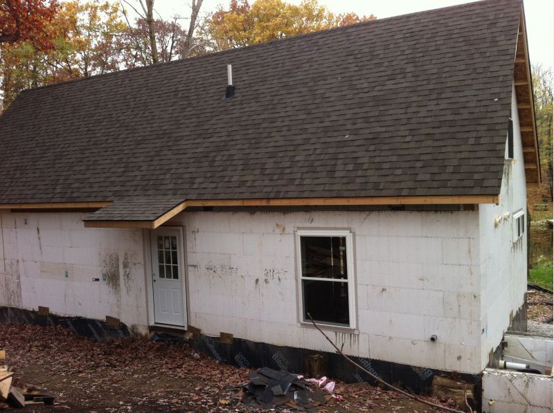

TheCabinCalls
# Posted: 31 Oct 2012 01:29pm
we have 13/12 and ordered one to fit
TheCabinCalls
# Posted: 31 Oct 2012 01:44pm
oops forgot the picture
