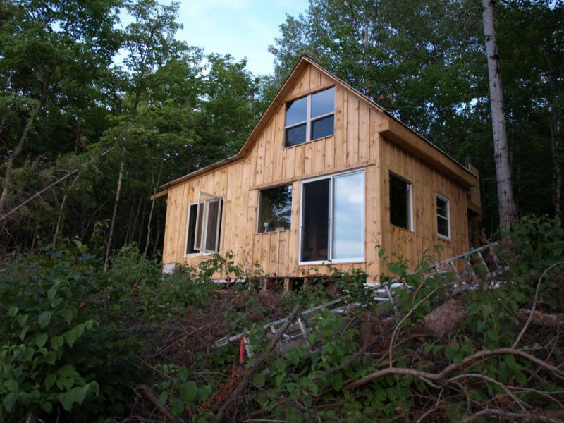

board and batten with plywood

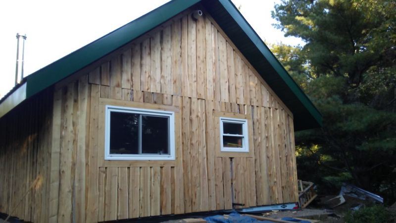

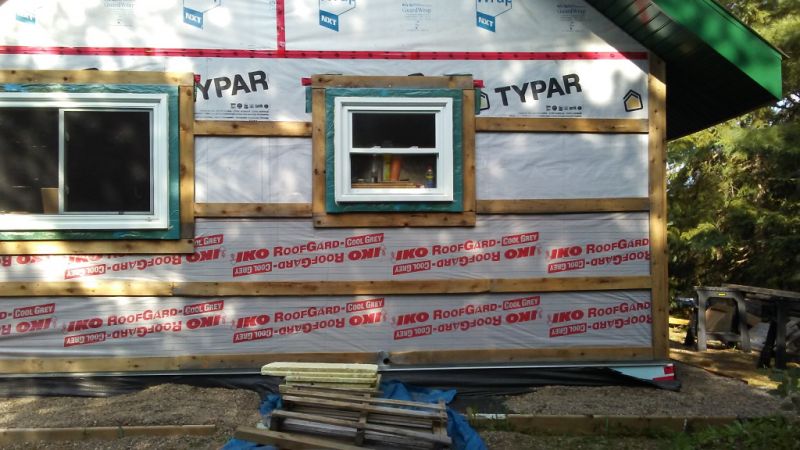

# Posted: 30 Jul 2019 10:49am - Edited by: Steve_S
Hmmmm boardandbatten first & only post
Well I did Live Edge Eastern White Cedar
Walls are built using Advanced Framing , sheathed with OSB and then wrapped with Tyvek Wrap + Gripper Wrap (roofguard) on lower 4', which is a tougher & thicker variant).
Not shown, is the 8" wide back boards that have 2" of space to allow cross flow of air behind the siding boards to prevent moisture buildup and to maintain a thermal break.
* Windows look weird eh ? Well they are built into Bailey Boxes which offsets them from the walls and provides a depth & thermal break as well.
PHOTO's as was being done.
Wrapped & Strapped
Wrapped & Strapped
West side boarded
West side boarded
